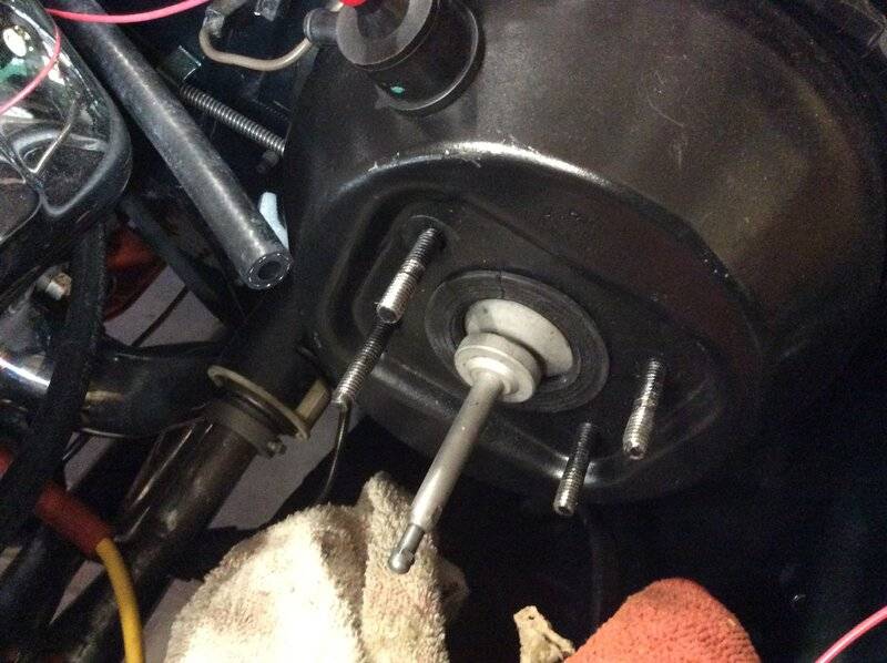

1967 Charger with drums all around and power brakes. My issue with adjustment of the booster push rod to get proper clearance to the MC is the pushrod is slightly too long even without the adjustment screw installed. The adjustment screw would add at least 3/8” when screwed all the way in. The whole booster and MC went to RocAuto for rebuild but now I can’t get the brakes to bleed properly. Attached are photos showing the rod length with my adjustment tool set to the MC piston depth. Anyone else encounter such a problem?.

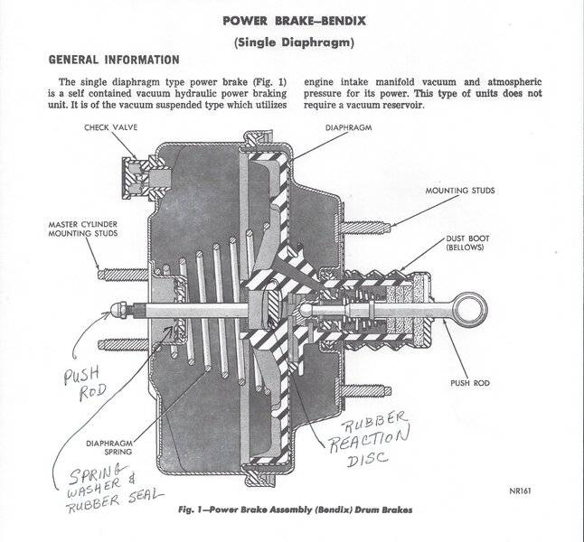

Here's a photo that shows some of the internals of the booster. I've labeled and drawn arrows to the components that I referenced in the previous text.

Anyway the point was, it looks like you have a Midland-Ross type booster not the Bendix type I posted about. However, they are very similar to each other and your '67 factory service manual will have many photos and text describing how to service the Midland-Ross. What I posted was for a '69 Bendix type booster.

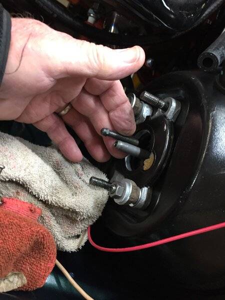

View attachment 1194445 The push rod pulls almost all the way out without resistance. Is that normal?
Yes, that would be entirely possible that it would slide out easily until the bottom end of the push rod comes into contact with the rubber seal on the inside. Somehow that rubber seal should come out of the metal can and the push rod will come with it.
