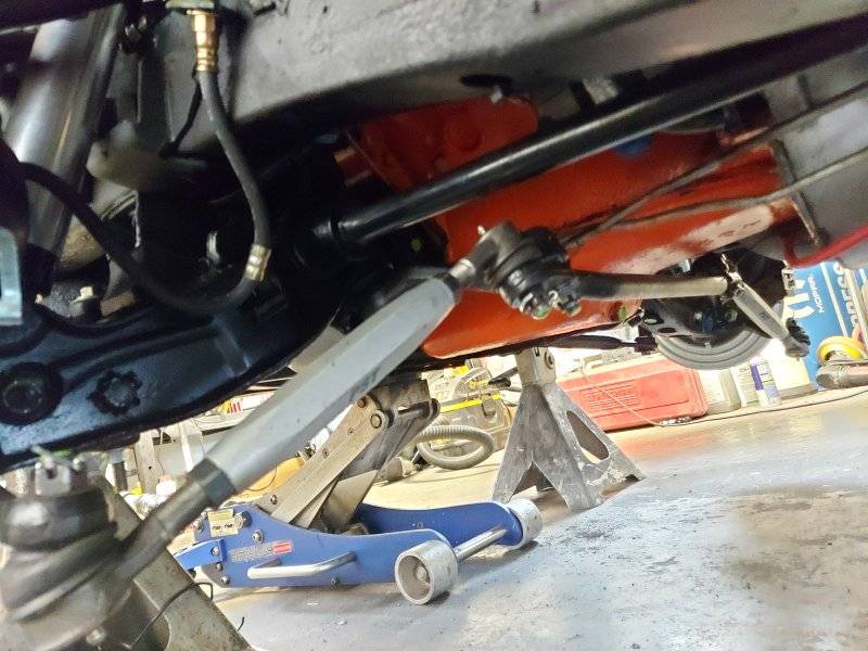

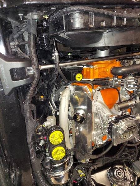

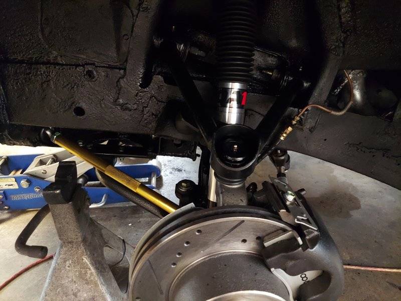

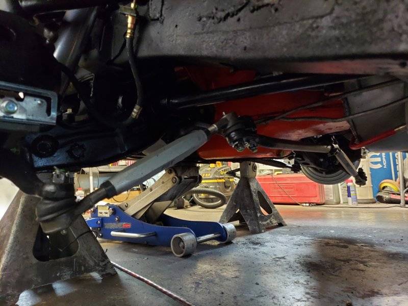

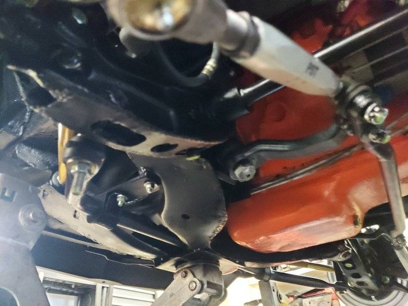

Did Borgeson or BAC ever say anything about the use of fast ratio pitman or idler arms? Are they compatible or not recommended with the borgeson setup? Can fast ratio cause any issues or is it just up to owners preference? I installed a new borgeson gear box kit, borgeson hoses and coupler with a new saginaw pump. I also installed new pst tie rods, w/ adj. solid sleeves and fast ratio pitman and idler arms. I have some mild issues. I used mopar +4 ps fluid, NOT ATF+4 by the way. My biggest concern is my steering still feels overboosted. Steering wheel moves very easy when engine runs and has a very tiny bit of slop at 11-1 but not as bad as a factory ps gear box. It's better, but just not what I expected. It also is glitchy like it doesn't have enough boost, fluid or air in the system??? I don't know. Its just not what I expected. I removed all zerk fittings due to clearance issues and replaced the fast ratio idler arm with a standard idler arm because of possible intermittent clearance concerns. I left the f.r. pitman on, checked toe for the 100th time, test drove and nothing changed.
Any advice or noticeable issues with my combination. I have no problem swapping the fast ratio arms out for standard arms if that will solve my concerns.
I triple checked torque spec on everything, bleed the system more than once, checked level when warm and cold, checked column/bolts, double checked pitman on gear box alignment, etc.
