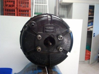

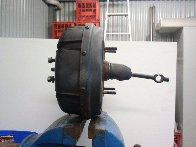

My brake booster leaks vacuum so I want to repair/replace it. I had a mechanic friend re-sleeve my original single master cyl. some time ago, and at the time he suspected the booster and master cyl. did not really belong together (probably because of the number of washers and several gaskets installed between the booster and master cyl.) From what I've seen of other 62's and in the service manual, my booster does not look original. Can anybody tell me the facts here?
Pics of my booster -

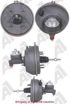

Cardone list this one for a 62 Dart as -
Part Number: 50-3533
w/5 3/8" Push Rod To Center Line Of Eye

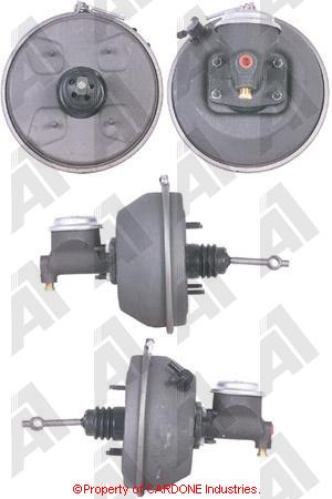

Cardone list this one for a 62 Polara as -
"Part Number: 50-3547
w/10" Rear Brakes and w/4 3/4" Push Rod To Center Line Of Eye"
Looking at the pics, I suspect the 5 3/8" pushrod model is correct for me, but I would love to know why the other length pushrod exists.
Anybody got a handle on this?
