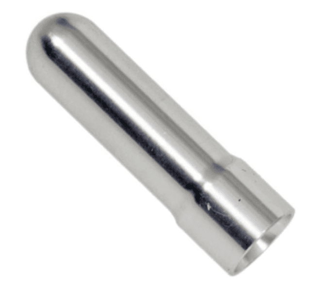

so... i was able to answer my own question. these are not removable. speaking with wilwood, you're supposed to cut that aluminum spacer to length.

i did utilize their supplied spacer. i first made a dummy one for testing out of a wooden dowel and would take .02 off at a time until i could fully mount the master flush to the adapter. yes it took me about 3 beers to accomplish this. but mine ended up being 0.660" long. i think took that measurement and cut the supplied spacer, beveled the edge and worked out perfect.

here is what Wilwood gives you as the spacer, just to give you some idea.
