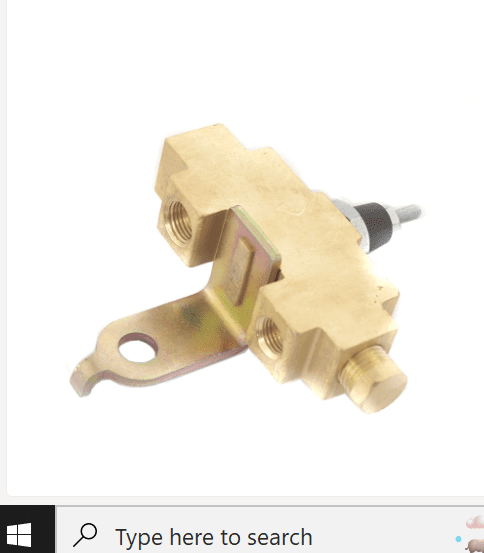

Hi im about to buy some brake fittings, just need to know what size the brake fittings are out of the distribution block to the rear brakes.
Are you asking about the flare nuts? If so the rear brake port takes a 3/8-24 for 3/16” tubing.
