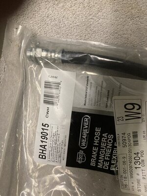

mr b, I'm working on a 62 Sport Fury. The hose thats on it relly gets stretched when lifted on the frame. What length of hose was the one you got from Advance? (BHA 19015) Thanks
