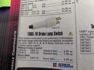

These are the ones I used-

going to jump in here. 70 GTX
Currently working on same problem. I don't have a stop bumper on brake pedal, but can adjust length by running switch up or down on its threaded housing. Looks like there are 2 different wiring set ups. Mine is same as Kern Dog pic's. Has an open set of contacts that closes when pedal depressed and I want to say Nacho's grounds out the circuit. Interesting that its listed as "Without cruise control" vs "Heavy duty"

Thanks everyone. Replaced with the heavy duty version.
