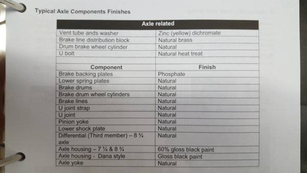

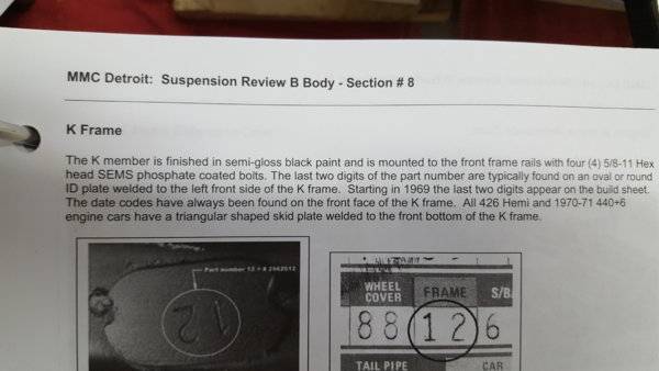

The second owner had the k member and rear axle housing powder coated gloss black. I want to start the as a factory resto and see where it ends up. Do you think these colors would work or should they be something else. If different how the heck do I get the powder coat off.

Semi gloss.....
Removing PC takes some elbow grease with stripper or blast it off...
These are from the pages of the David Wise B-body book. Take it for what it's worth - semi-gloss black for the K-frame, 60% gloss black (which in my mind is semi-gloss) for an 8 3/4" and gloss black if it's a Dana.
