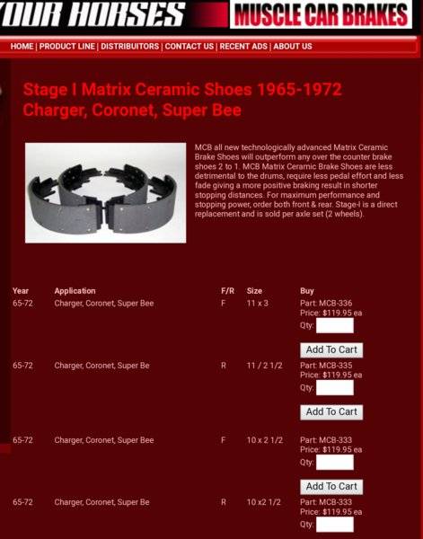

I have a 64 Fury, all new 4 wheel power drum brakes, 65 drums (kept tapered axles), 10x2.5 pads.
Drums and pads keep glazing. Pull them, sand, work great for 3-4 weeks, repeat.
Does anyone know if these pads will fit a 64?
Whether you click Charger or Satellite the part numbers are the same.
http://musclecarbrakes.com/stage16572charger.html
I'd say your best bet is to call them and ask, eh? They use a ceramic, semi-metallic compound (like most modern disc brakes do) that's going to be very aggressive.
By the way, if you have four wheel drum brakes, there's not a brake "pad" anywhere on your car - them thar is shoes.
I do know at least one member is using MPB brakes on their car (I want to say @Dennis H maybe?) and if I recall, they love 'em.

I will definitely call them, but it always helps to find someone who's had direct experience using 65-70 shoes on a 62-64.
Anyone have a good pic of a 65-70 brake shoe?

Muscle Car Brakes has a "brakes in a box" kit that includes all the hardware.
I wasn't aggressive with the brake in, cleaned new drums well, probably crap linings which is why I was looking at the MCB which are ceramic, and easy to source new.
