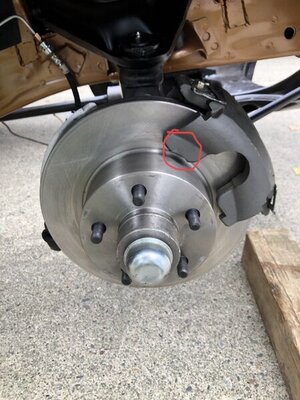

My ‘69 Coronet came with manual disc brakes off of a ‘75-76 A Body. I decided to keep them, so I bought new rotors and pads. All of the parts matched the old parts.
When I put the new pads and calipers on, the rotors turned very stiffly, and when the wheels went on, they turned a little bit but rubbed on the calipers then wouldn’t turn at all. I took the outer pad off each side and everything spins and fits just fine.
Are my pads too thick or am I missing something else?
Here’s some pic of the old rotor, new rotor and outer pad.

Your first photo appears to have the outer pad in contact with the rotor hub. Not sure if your new parts place the outer pad in the same position. In the first photo the tabs on the outer pad are not in the correct position on the caliper. The outer pad needs to have those tabs bend so they are an interference fit on the caliper. That might be the trouble.
That new caliper doesn’t look like it’s machined right. Looks like the corner is missing the recess. Those bottom areas locate and position the outer pad.
I will try that. I didn't realize the tabs were supposed to be bent. Should the brake shoe sit snugly in the caliper without falling out then? The old ones just fell out when I pulled the calipers off.

The pads should not fall out. The outer pad should snap in with no vertical movement. The inner pad just drops in on the caliper adapter. I bend those tabs trial and error and put the lower part of the outer pad on the caliper first and rotate the pad until the tabs snap over the caliper. Again, make sure there is no vertical movement of the outer pad. Make sure you lubricate the caliper machined surface.
I'm surprised that your caliper looks like that on the lower side. Mine has the recess areas on both sides and holds the brake pad securely in place.
