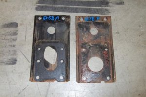

Good question. I don't know if the plates are different. I don't recall anyone looking for one or the other so they might be the same?
I saw a post once on plates for different applications and I'm pretty sure the hole positions for power V manual are different.
Was your car always manual brakes KK?
EDIT - I see in your pic, the brake pedal has 2 holes - top for manual and lower for power... I seem to be answering my own question..
