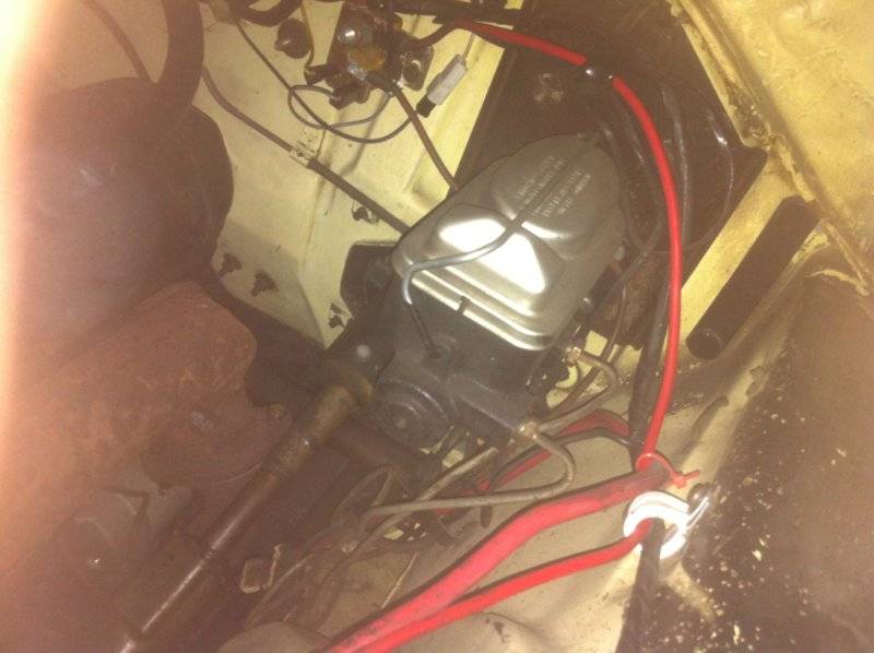

Finally, last question: The goal of this car is to be kind of a brute. Turning the wheel takes some force, a hard-shifting, hard clutch, hard seats kinda deal. I want to feel like I've gotten a workout after driving it! I don't know if you guys have read the '77 Car and Driver where they talk about the police Monaco. They say it's, more or less, a "real man's car," where you're using your muscles to make this stubborn sumbitch work with you. That appeals to me. :) The car originally came with non-power drums. When the rear is all buttoned up, I would like to upgrade to non-power discs, and bought a Master Cylinder off of ebay advertised for manual discs. The M/C itself is much taller than the original drum M/C (for the extra fluid, I'd assume...) but the bore is 1 and 1/8th inch, and everywhere I can find, people say that's far too big for a manual application. Its part number is for a '71 Coronet taxi with manual discs, so I wanted your opinions- do I need a smaller diameter bore? I'm trying to use as many period-specific parts as possible, so if the larger diameter bore in the M/C means I'm gonna have to really put my weight into hauling this sucker down from speed, that's great- I don't want some mushy pedal nonsense. :)

Bought NOS rear diff rubber/brass block hose off of Richard Ehrinberg for 40$. Stainless lines leak with DOT 5, best brakes set up are slider adapters off a 79 R body, you need at least 15" wheels with 11.75 rotors, seen here with 15x7" Diplomat wheels and 74 Duster spindles. Big bore master means less pedal travel.
