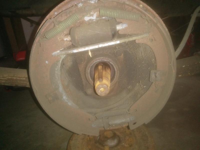

Hi everyone,

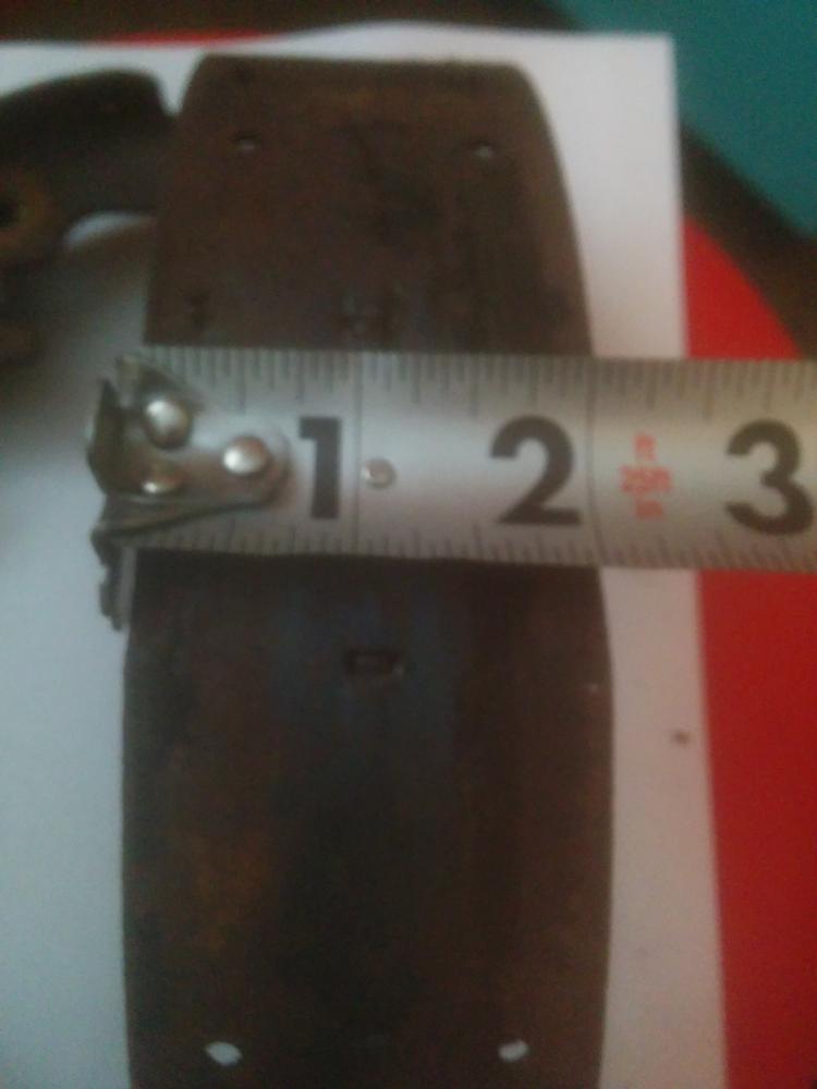

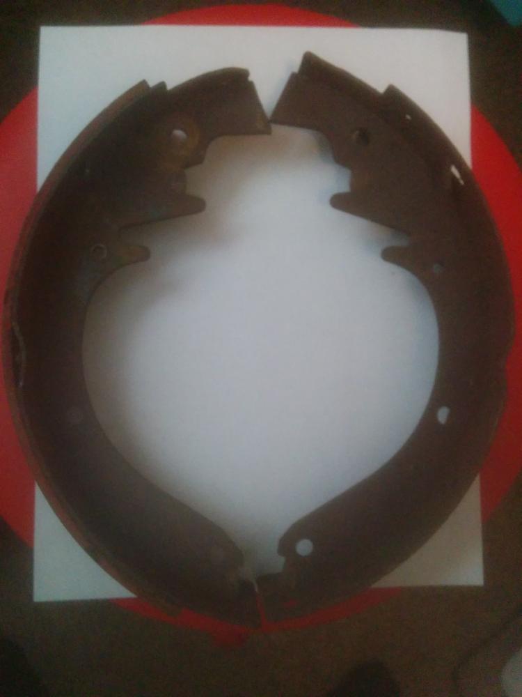

I'm trying to replace the shoes on my 62 Fury project. The shoes I took off the car are 2" wide, but all I can find online is 2.5". Does anyone know where I could get some of these or what they are? Is this a different rear axle than stock?

I went through our books here and the 65 Fury had 11x2 rear shoes. If you can get me a casting number off one of your wheel cylinders I may able to cross that and verify? If that is the case we do have the shoes available.
