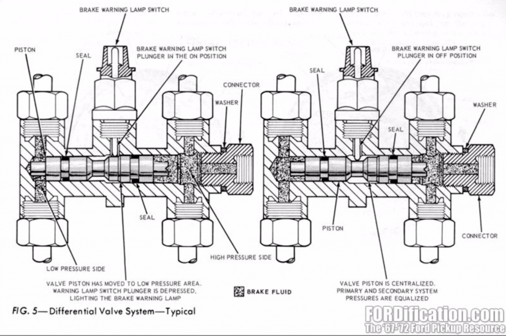

The sliding pin in the valve moves to one side or the other, depending on if there's a loss of pressure, front or back. You'll have either front or rear brakes if the pin is out of position. You wouldn't be able to bleed either front or back in this situation. So it should be ok.

If it's a one terminal switch, then the switch provides a ground when activated by the pin being off center. The wire is the ground for the circuit, which is normally "open". When the switch is activated it makes "ground" to complete the circuit, which activates the light. Also if the pin is stuck off center it should be blocking either the front or back brakes from any fluid.

This is a Ford but you get the idea.

Thanks everyone. I see now that the warning switch is in the "metering valve" and the proportioning valve is the other brass block. A guy (ron?) on Moparts said I can re-center the piston by stomping on the pedal 10-15 times & the light should go out, then I re-gravity-bleed. I will check the wire while I'm at it. If that doesn't work, I need to pull the master cylinder (probably swap it out while I'm at it) & figure out how to measure the booster rod 0.910"-0.920" end of rod to face of booster.
