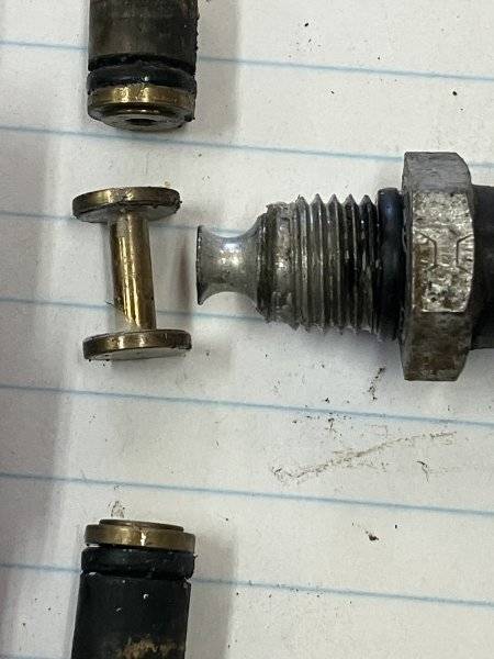

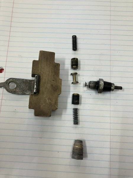

There is a shuttle in the proportioning valve that moves back and forth between the front system and rear.
This is a drum-drum block but the principle is the same, Maybe the valve is defective and instead of allowing maximum pressure to the front, it is blocking it?

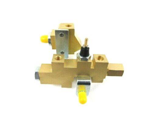

From what I read. You should install a metering block and an adjustable proportioning valve to change the brake bias. Use the adjustable proportioning valve on the rear brake line. The metering valve is so that you can maintain higher pressure to the front calipers and lower pressure to the rear line if using drum brakes. They make and sell a metering valve that is specific for front caliper and rear drum applications.
This is the part.
And this is what it looks like.

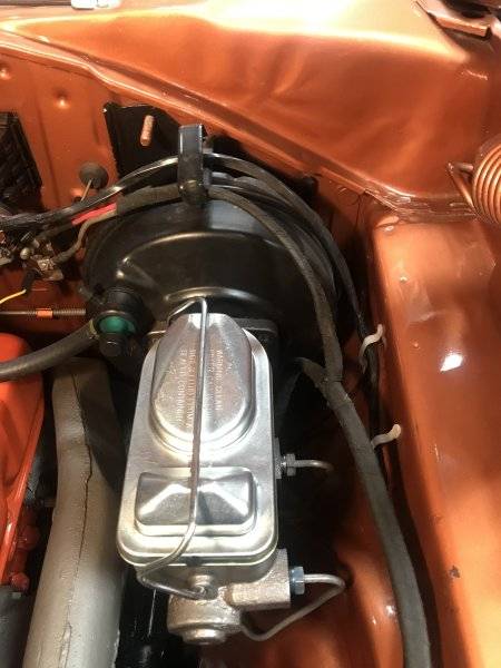

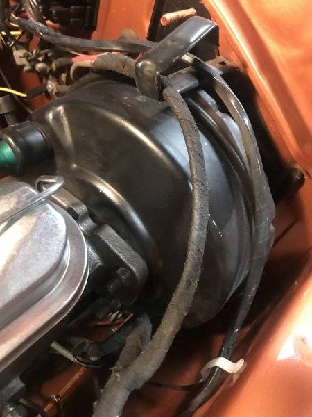

This is the booster I have, and the backing plate and linkage appear to be correct.
That is the single diaphragm booster for drum brakes. You need one like this. It is a direct replacement although it is aftermarket and has a larger rubber boot on the back. You will need to enlarge the hole in your firewall a little to install it. It comes with the backing plate and linkage but is the same as what you already have.

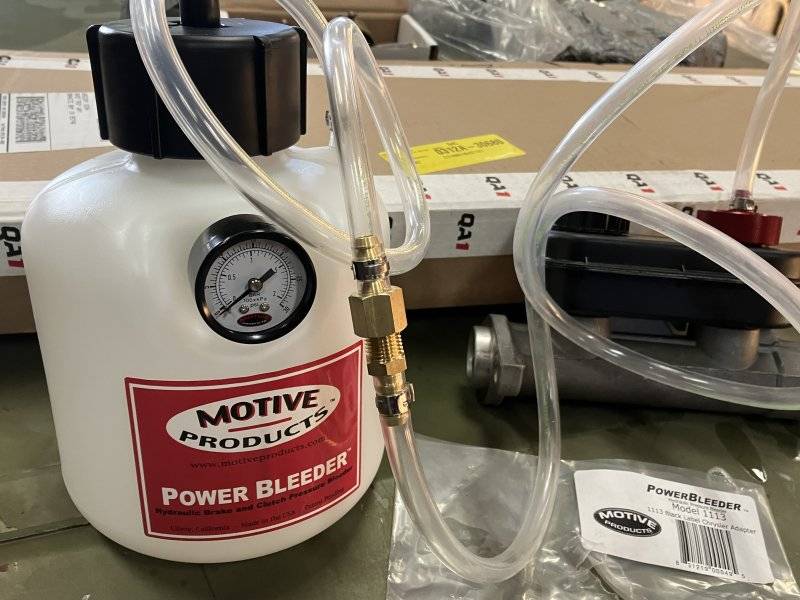

These units are great for bleeding brakes:
