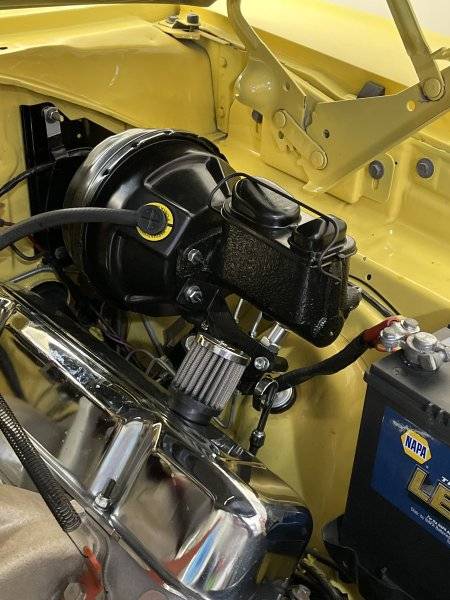

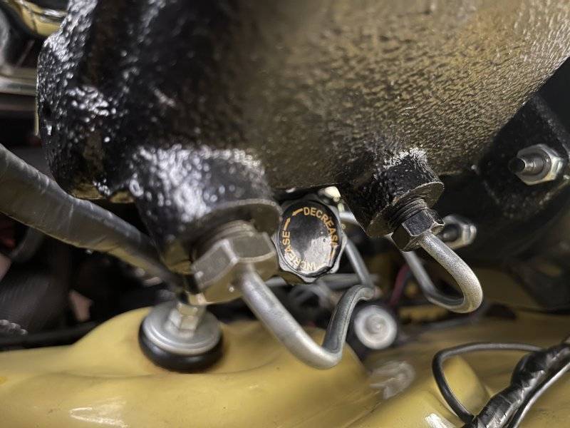

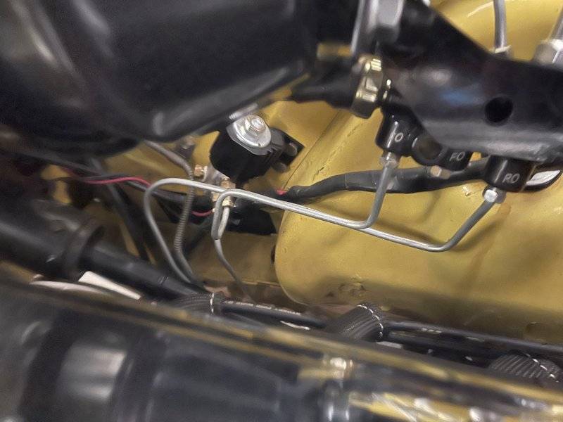

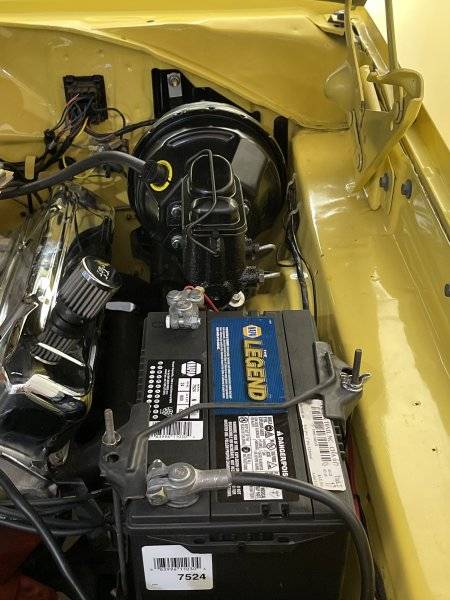

I just completed my switch about 2 weeks ago on a 69 RR. I went with Pirate Jack. The kit was totally complete except for some brake lines you’ll have to make. I did drilled and slotted rotors, braided hoses, new spindles. There are some choices of the finish you want on the booster and different master cylinder also. I wanted the OE looking master instead of the GM looking one. I went from manual drum and did not have to cut the firewall. The propositioning valve came with lines to hook it up and is under the master in my application. And yes, I added line lock since everything was apart anyway.

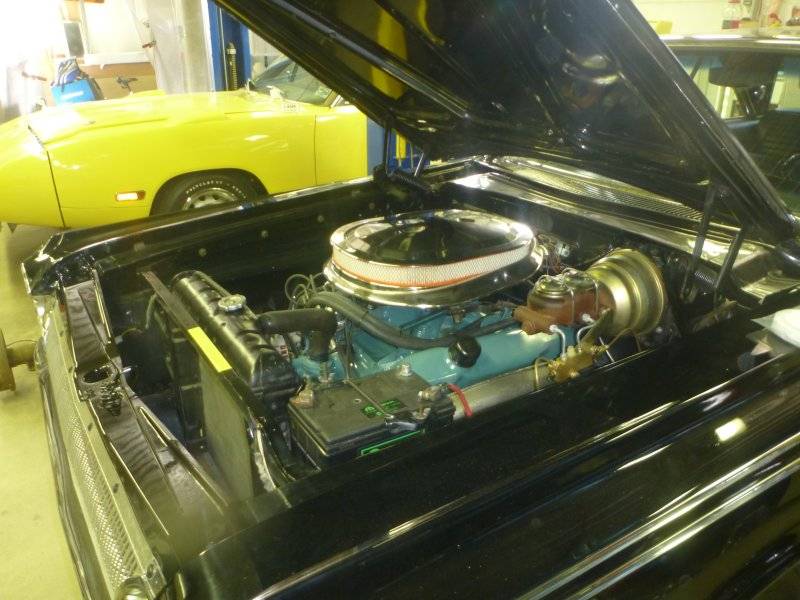

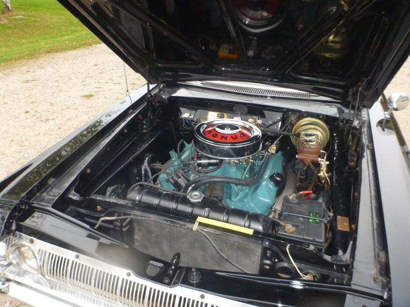

Just don't buy one of these ugly forkin things that the previous owner put on my '64. It also dented the hood.
Yup do not get the Right stuff Detailing kit. The boosters stop working for no apparent reason. Same as above.
