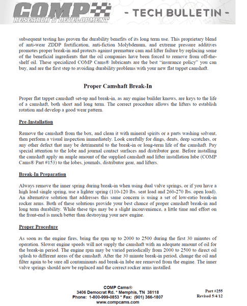

If your spring pressures are correct and not excessive, break it in like it is. If you have any doubts remove the inner springs and break in for 20 minutes at 2000 rpms or more, then reinstall the inner springs and make a second run for about the same amount of time and rpms. You should be good to go to the dyno.
The pros typically say less than 300 over the nose is okay... If it's more than that take the inner springs out.... It's allot easier to R&R the springs than trash the engine....

Does the camshaft manufacture recommend it per their instructions? Then yes, i would.

comp cams doesn’t mention anything about it
This is exactly what Comp recommends.....and pretty much every other supplier.

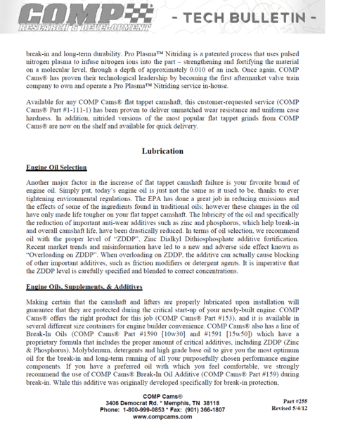

I will say this. If you can swing it, pay the extra for nitriding. We had one HFT break-in go bad, lots of fuel wash due to a sudden stuck float problem, cranked forever without starting, got too hot once it did fire up, you name it...and that engine is still running great today (and it's a FORD ahhhh!) Of course I can't say for certain the nitride treatment is what saved it, maybe just luck..but who knows. By all accounts that cam (a fairly aggressive grind) should NOT have survived..
yes I did get the nitriding. Heard good things about it as well.
