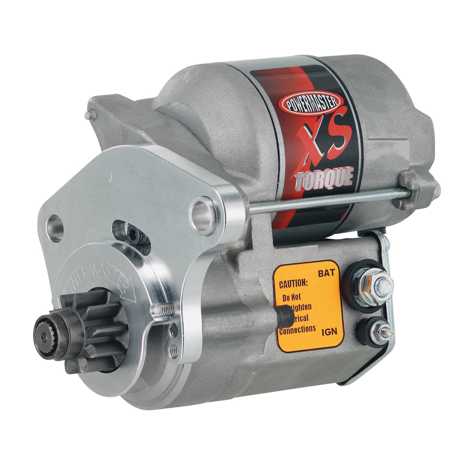

Starter mounting bolt holes are OK. Plan to use high-torque ministarter.
Starter Pilot broken on my 1967 727 transmission case.: Is case useable?
Bell housing before clean up. Starter mounting bolts look OK.
So its not really needed - there are starters sold that do not use this pilot hole. I like to use it. It is repairable, but is it worth it? I have the capability to fix that in my shop. But if it were mine, I would replace it. But I also have several spare cases.
