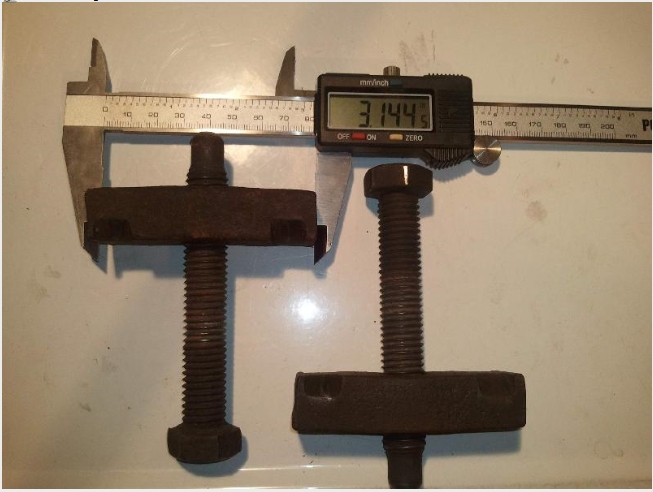

Cant see it in this but believe me they were course thread. Fine thread are the best. lol
Here is my spare set of late Cbody adjusters
