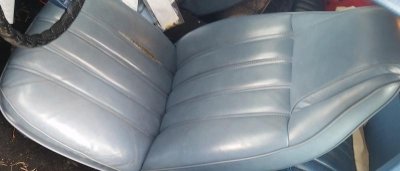

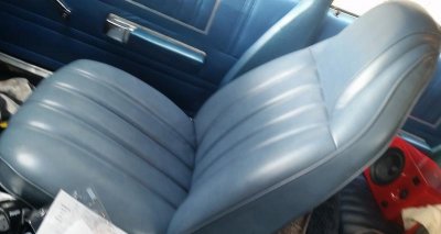

Got some pics yesterday. First two are through the glass, soory about that.
Last one shows the unnecessarily long adjuster knob, however, the trim piece is missing from that side. For the record, the rear seat back is just sitting there and is from a 73 Duster.
Those do look pretty good. Have a custom back seat cover to mimick thenm and they would blend pretty good.
