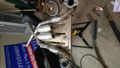

Spent the last 2 days building the front half of my new 2.5 x pipe exhaust.
