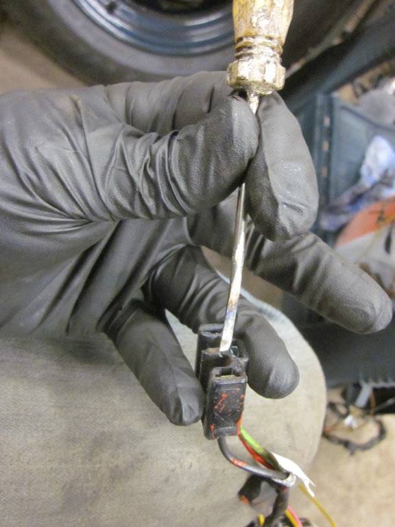

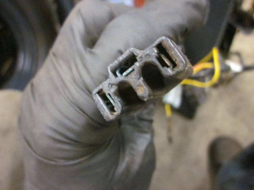

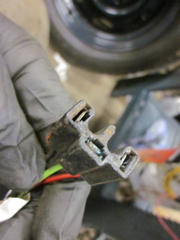

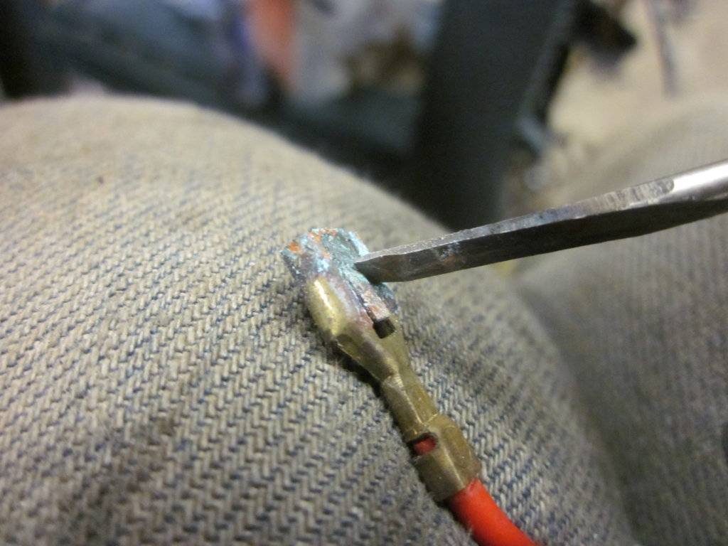

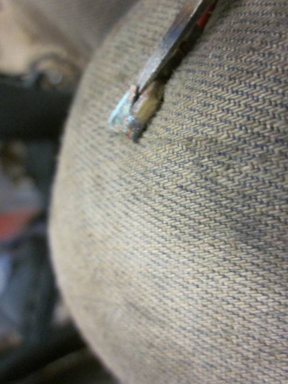

Here's a few pics from some recent work I did on the 64. The highbeam switch connector usually sees a lot of moisture and can get nasty. Just spraying it did little to remove the oxidization.
View attachment 516724 View attachment 516725 View attachment 516726 View attachment 516727 View attachment 516728 View attachment 516729
yes your absolutely correct those spray cleaners are great for dust and light dirt but will not remove corrosion, deoxit works well after cleaning to prevent further oxidation.

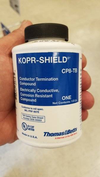

Glad you got it fixed up Rebel...just for fyi I've always used this stuff on connections. Not cheap but superior to dielectric grease..a little dab'll do ya!
