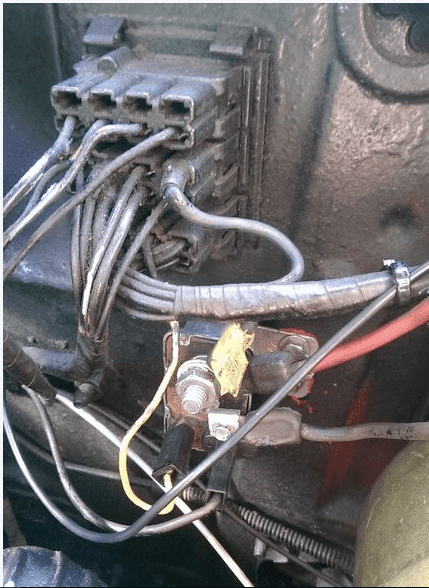

Thanks Guys. Here's a pic of my bulkhead. Will post before & after pic's on Friday. One last question how do you get the wires out of the harness? I'll probably just leave them all in place but just in case...

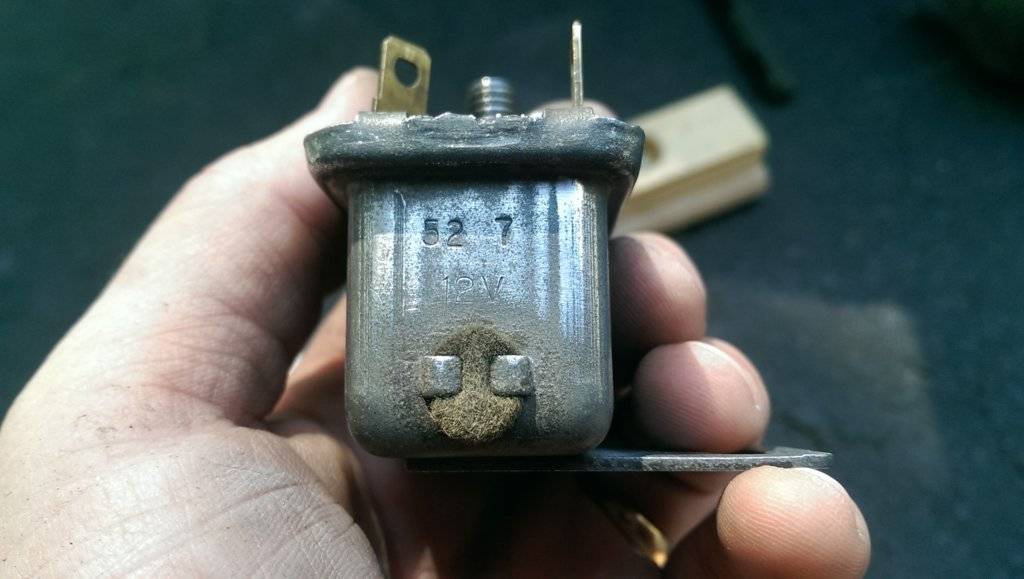

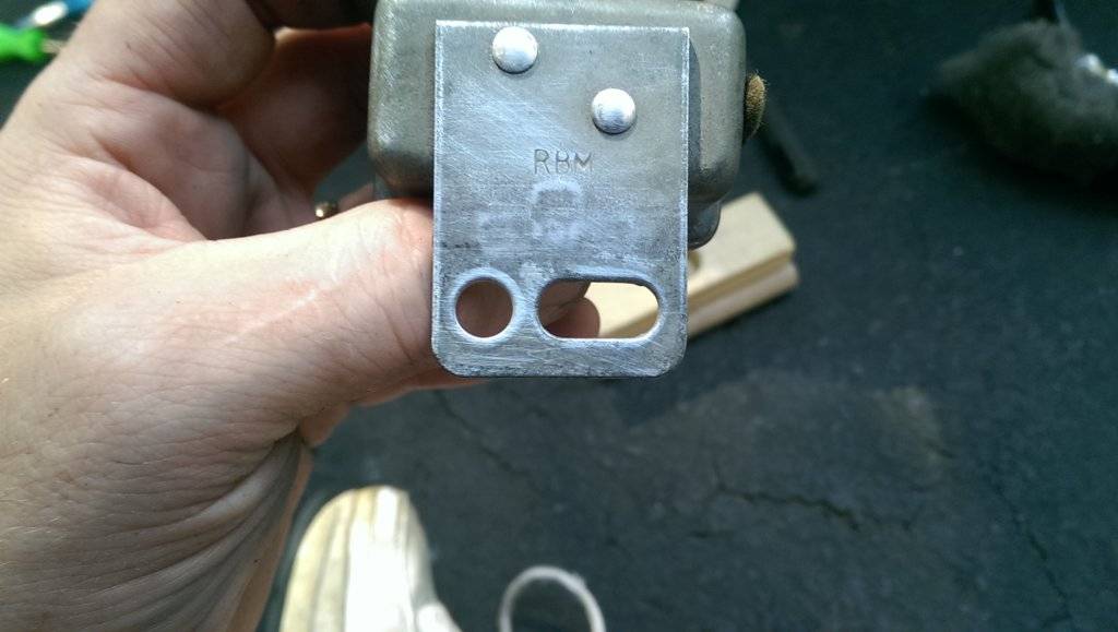

Here a some before & after pic's of the orig. starter relay on my car I cleaned up last weekend. 2 owners ago sprayed entire firewall black with everything in place...

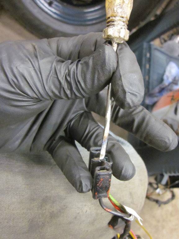

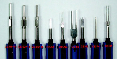

I removed each terminal, sprayed deoxit and lightly scrubbed with a fine steel brush until clean. Each female terminal has a small tab on top that can be flattened by gently pushing a narrow flat screwdriver in from the the front. The male terminals have to be pressed closed to remove. I gently pull and wiggle the wire while pressing the locking tabs until it frees up. Sometimes you have to push first to flatten the tab.
Yup need one of these or the pic type..I use the red for most of the older weather packs that use make/female spades

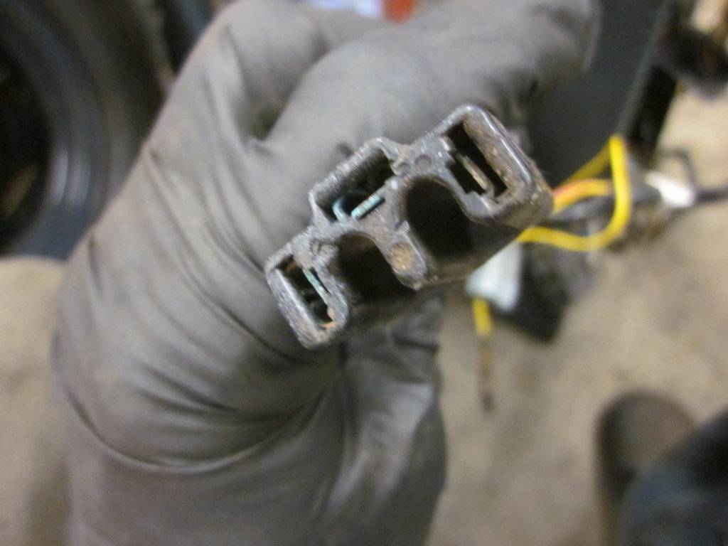

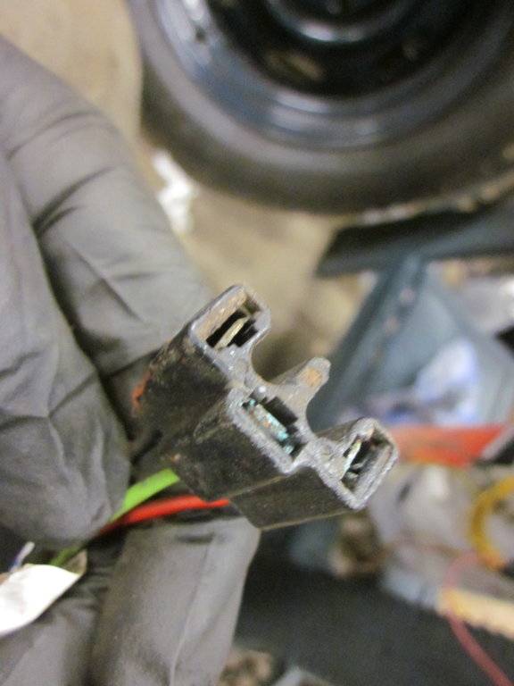

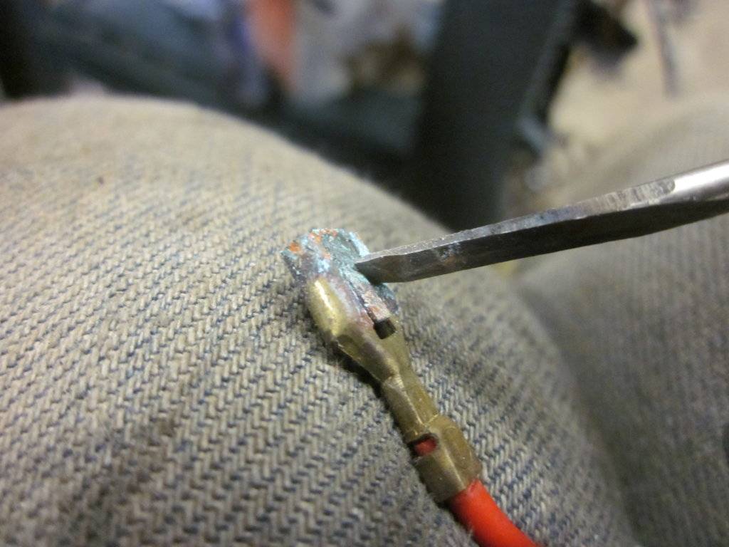

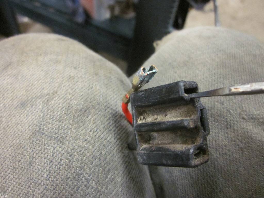

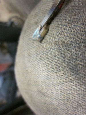

Here's a few pics from some recent work I did on the 64. The highbeam switch connector usually sees a lot of moisture and can get nasty. Just spraying it did little to remove the oxidization.
IMG_4572.JPG IMG_4573.JPG IMG_4574.JPG IMG_4575.JPG IMG_4576.JPG IMG_4577.JPG
I've never even heard of some of those cleaners! Learn something everyday.:p
But, from experience, soaking terminals in lemon juice (citric acid) will clean brass and copper, and remove the corrosion. Best overnight! Won't hurt anything, either.
I agree, unless you know what your doing, wouldn't try taking the terminals out of the blocks. Spray the thing with degreaser...then soak in the juice.
