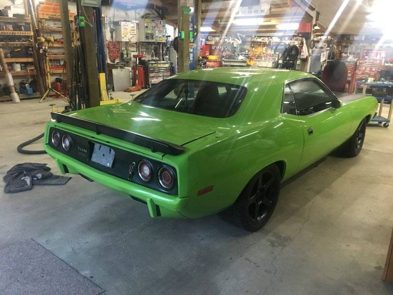

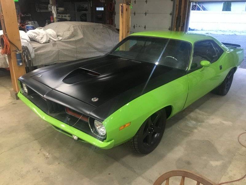

Doesn't have to be stripped, grind the chrome off with like a 40 grit flap wheel, then smooth it all out progressively with finer grits. Hit it with etching primer, then prime and paint as you would the car. I did the ones on my Cuda.
