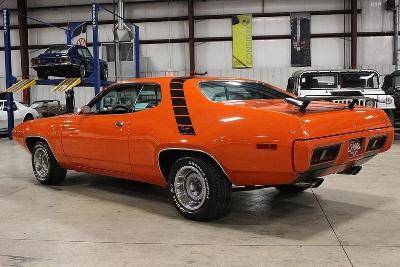

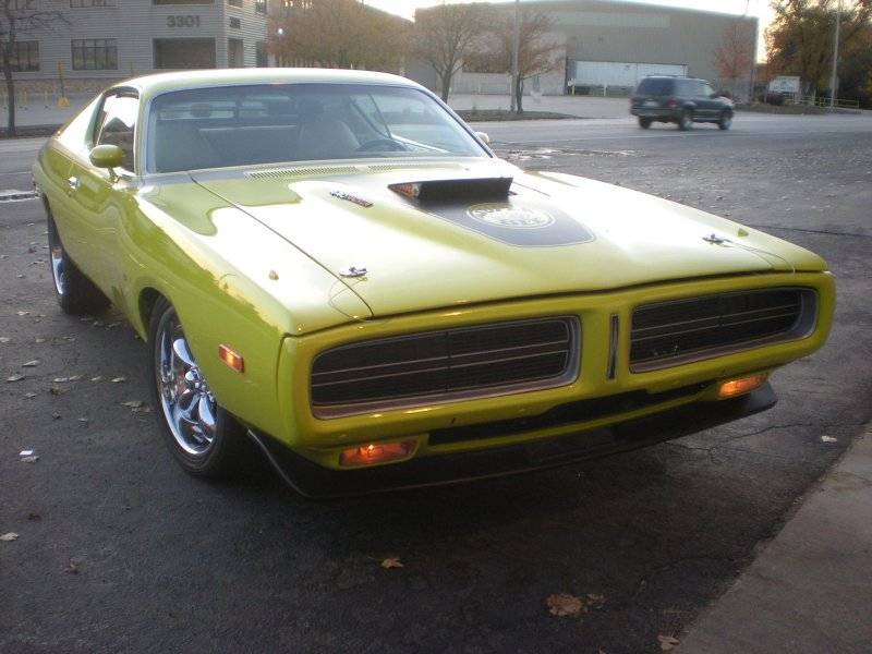

Agree, I sanded and epoxied mine and sprayed them in Eastwood under hood black. Bullet proof.I would sand, epoxy and paint as mentioned but also make sure that you have good paint on the inside of the bumper as well. You don't want problems with the chrome lifting off of the steel later. This goes for bumpers that are left chrome also. I think it will look good painted
