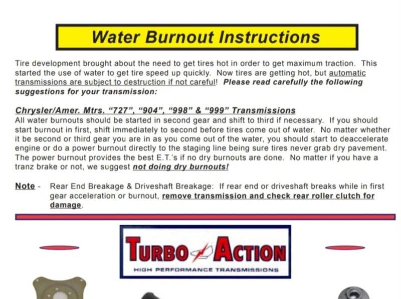

Watch the above video for important info, especially the last three minutes. Two other things to remember... 727s are hard-core tough... you can start your burnout in second gear...if your motor is got the uumphff to do so....won't hurt the trans. If you do start in first, just get out of first asap. When and if you rebuild, use a better front drum and a bolt-in sprag. Most important of all, if by chance you break a ujoint or diveshaft under heavy load like a burnout, THE TRANS MUST BE TORN DOWN AND THE SPRAG AND BACK CASE CHECKED BEFORE USING IT AGAIN!! This is exactly what causes the bomb seen above.... fried sprag will allow the front drum to overspeed way beyond its capabilities.
The thing a lot of folks may not realize about the UTG vid seen in post #1 is that crappy old trannies are limping around with worn out sprags. You can still get the thing to move by manual shifting....behavior is different from first gear in drive and manual low..... but beat on it like this and BOOM.

That’s exactly what NOT to do with your 727. Never let off in first with that valve body.

Just never get back on it in first after pedeling it.
I think the trans blew up in Tony's video cause it wheel-hopped on the first attempt, rolled the sprag and then the driver tried it again, in drive.

Agree with 6PKRTSE. I never, ever do a burnout in first gear. Second only, or 2/3. If you MUST do a burnout in a 727 without a manual valve body, do it in first, not drive, and allow it to shift to second before backing out of it.
