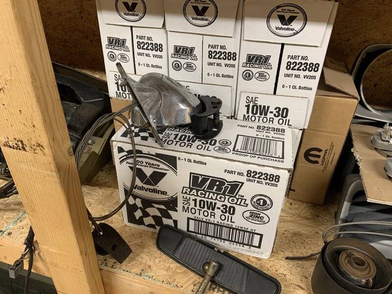

I do the exact thing on my fairly stock 440 in the cuda. Actually it all went on sale at Walmart a month ago and bought enough for 4 oil changes.
Then I saw the following video. I'll use up my stock and may rethink.
I buy premixed VR1 for my 500hp 440. For my fairly stock 440 in my 71 Cuda I buy regular Valvoline and add a bottle of stp. Most info I find on zinc says once the engine is broken in, the higher level of zinc isn't needed anymore. Regular valvoline oil has sufficient zinc in it. I still like adding a bit of insurance though.
