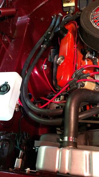

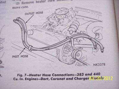

Your heater hoses or not installed according to the diagram I posted,,,, Don't know if it matters much tho...
Sometimes it does - the valves usually control and shut off better depending on how the disc and seat are arranged. Usually better to shut against flow, vs shut with the flow.
