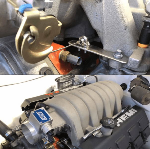

I'm doing a gen3 hemi swap and using terminator x max for engine control. I don't think I want to use the electric throttle body because I have a 46re trans. What cable throttle body are you guys using? Thanks, Dave

I didn't want to run an GM TB + adapter. Lots of others have...
BBK also keeps the throttle cable on the driver's side, which I prefer.
These are not mine but gives a good idea of how I will run the throttle cable on our 6.1
something like this...
or this... or something very similar...
I originally bought a BBK for mine, but it was expensive and the sensors didn't match the Terminator X kit I bought. I ended up swapping it for an LS one from Fitech and an adapter plate. It came with the sensors and was a lot cheaper. Looks a little better as well in my opinion. The throttle cable routing is a little awkward, but it works. Word of advice, stay away from the Fitech cable brackets. They're all junk. The Holley version is much better.
