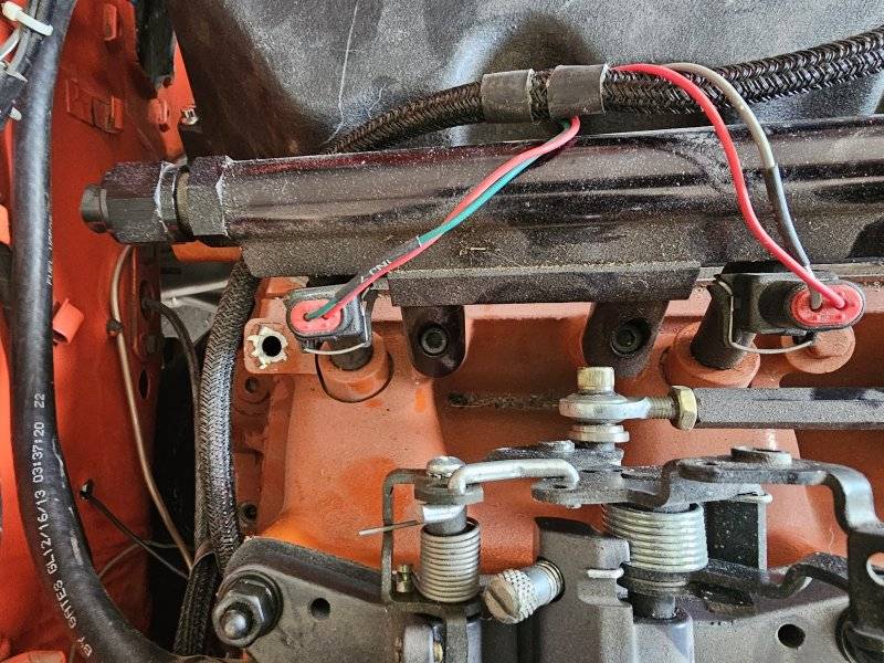

I have a 572 Hemi with dual Holley throttle bodies, but should be similar to the dual quads. It is a stage 5 intake. I'm looking for a throttle cable bracket that will work for this application. This is my first Hemi, so I'm looking for others that have more knowledge about this.
Also, it's a 69 Bee.

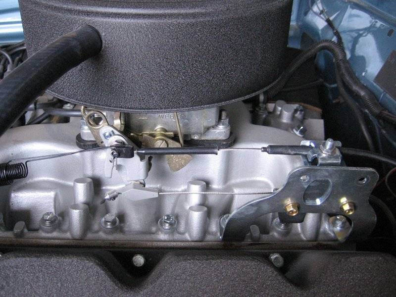

I have the same car and engine with a mopar marine intake and dual edelbrock carbs and used the stock cable with a modified stock bracket. I also have a stage 5 intake and it is a tad taller but I think the same setup would work.
I got mine from Mancini,also Indy Cylinder Heads carries them.
It is adjustable and can work with both single(mine) or dual quads
I had the marine intake with dual 1407 Edelbrock carbs on one of my Hemi's. I used the production street Hemi brackets, and also a Edelbrock progressive dual quad linkage kit that I extended slightly to make it work as needed.
I'm thinking it will have to be on the base of the throttle body because of the rails?

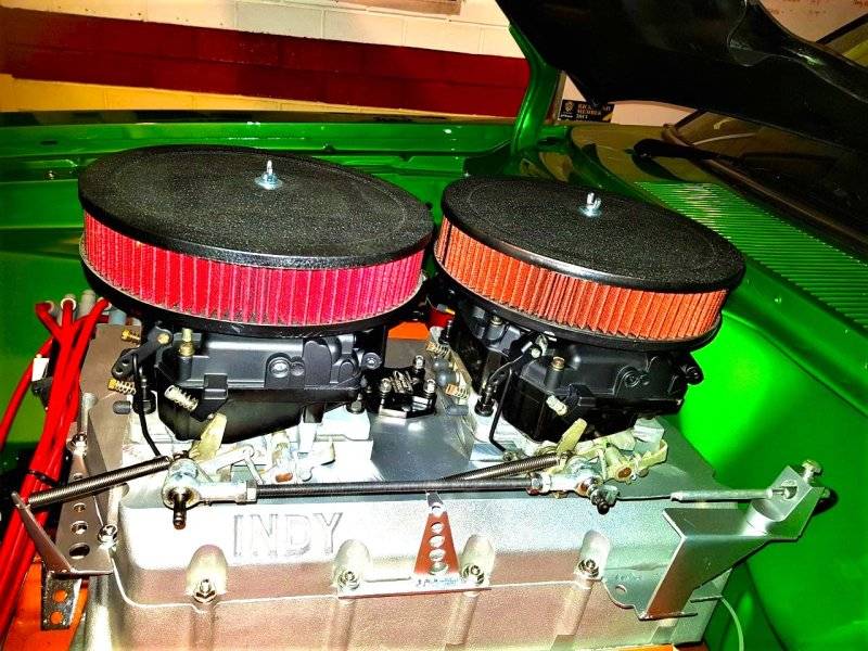

Why not use a bit of imagination and have a go at making your own ? Did this on the Indy X ram and my Stage V dual quad intakes.
On the Stage V intake the cable bracket mounts off the rear carb's rear carb studs; on the X ram the cable clamp mounts to the intakes top lid studs as in the pix.
The cable is pulling in line with the carbs this way. I'm not a fan of the commercial offerings really.
Use two rod 1/4" rod ends and some 1/4"SS rod, some silver paint and you're done.
Easy ;)
PM me if you want a pic of the Stage V bracket ;)

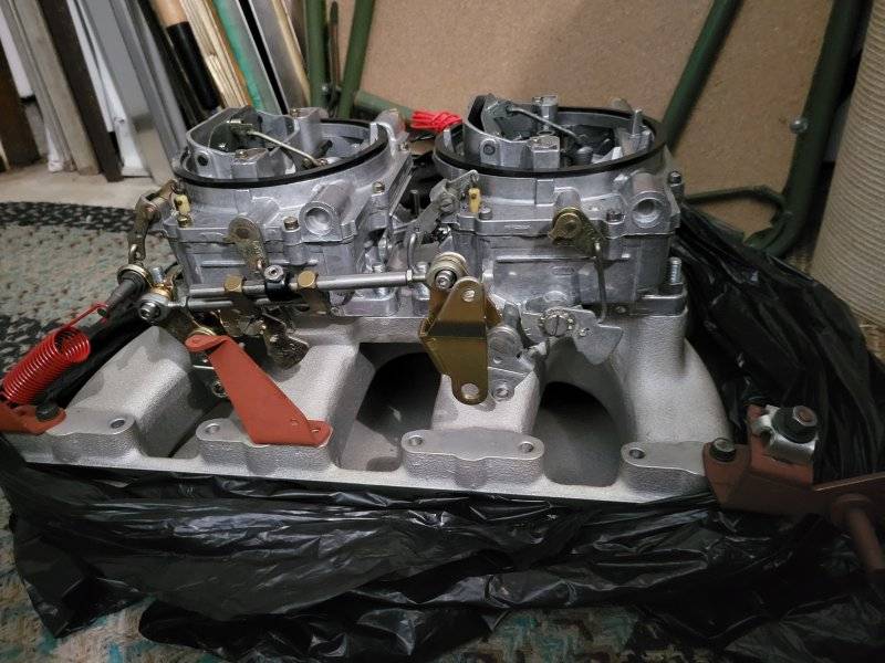

I do not have my engine together yet. I have the Edelbrock #7524 intake and 2 #1405 Edelbrock carbs. Stock throttle cable bracket with an Edelbrock adapter the attaches to the rear carb linkage, straight pull for the cable. Just have to make some small bushings/spacers to even things out for attachment and brackets for return springs. Also, I am assuming that both of your TBI's operate at the same time, my carbs don't, have to do to a different hole on the front carb so that both carbs are at wot when floored. Wasn't that way when I bought it.
Don't know if this helps. Good luck!
