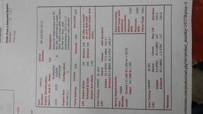

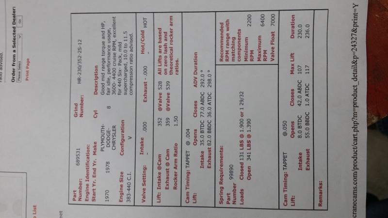

Im running a stroked 440 (493) edelbrock rpm heads 84cc , hydlalic roller cam , 3000 stall,my final compression ratio is 9:7.1 this cam works well for me can drive it all day long on todays pump gas. It a crane pt #689531 /HR-230/352-25-12 this is the cam card
