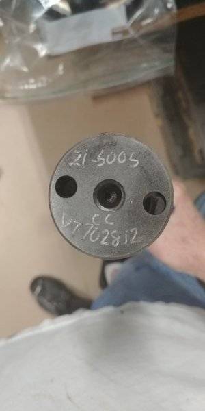

20180629_194247.jpg.html
Check on the end of the camshaft. sometimes there are numbers on them. Google and you may find it. I found out the cam in the rebuilt engine for my 71 runner was a Thumper cam this way. good luck.
