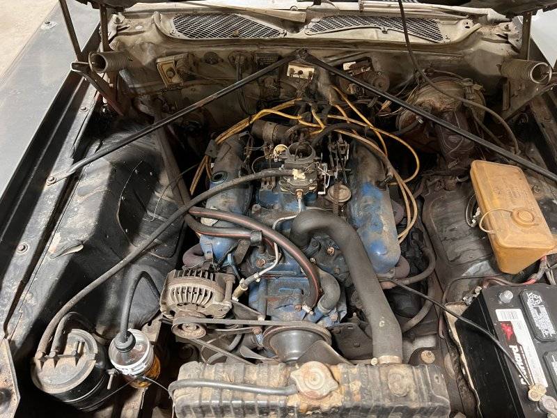

Thanks for all the great suggestions. To answer a couple questions I guess I would like to see if I can get another 30HP or so out of it without any major work. I also know I've got a lower compression engine due to it being a 1973 so I'm just hnt sure what my best options would be. So I'm not looking for a drag strip car, but a little more fun to drive would be great. Right now it's a wonderful daily driver. But its "get up and go" wouldn't be much better than driving a honda or toyota. It's got plenty of power to get moving but nothing too fun if that makes sense. Budget would be somewhere between $1000-$1500.
I guess I'm asking, if you inherited this car today and wanted an increase in power and torque, what would you do?

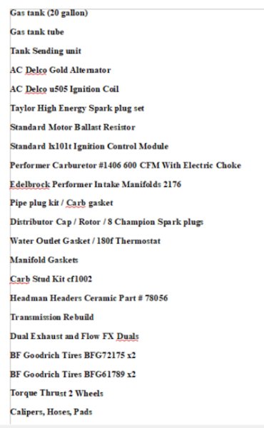

Not sure about your list. Which ones are necessary and which items are wish items?

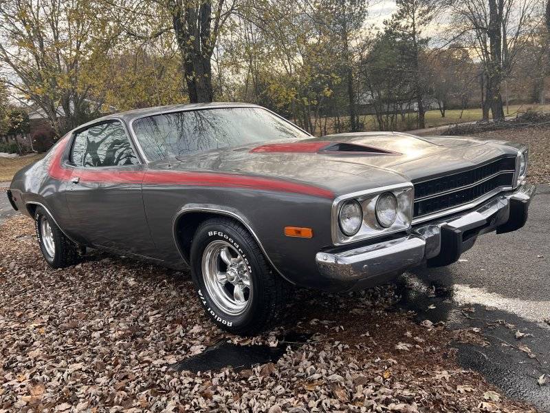

It looks like you have already changed the wheels and they look like a nice upgrade from what you posted in any earlier thread.

The car sat for awhile? I would flush the cooling system and take the radiator to a shop for cleaning and pressure test. Maybe you already have? Flush out the brake system too.

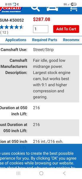

I spoke with summit yesterday. Based on my current setup they recommended this Cam. Have any of you ever tried this one? He said I wouldnt have to do anything to the car other than install the cam, that my particular engine, compression and current parts would all work together great.

I'd do the Summit cam I posted (6900) before the one just above.
It's a more modern profile and better for factory exhaust manifolds.

As mentioned above the Summit Cam with 216 @ 0.050" duration would work best with around 9.5:1 compression. The cam will work with the lower compression, but it hurts low end torque. I was suggesting a pretty mild cam thinking you want to use the stock torque converter. A high stall converter is a great addition when going with a larger cam in a low compression engine.

You have no compression. Summit?
Don't go to a counter person for performance advice.
From their info...screenshot
They say it works best with 9.0 compression and higher. You got 8.2 on a good day.
340 and 360 heads are great. They will also lower your compression by .5 -.8 of a point. Going the wrong way.
Post #2 by me said a 252° cam. Better to have good torque, its better than no power.
Yes, too much cam with no compression will be slower than a stock 318.
