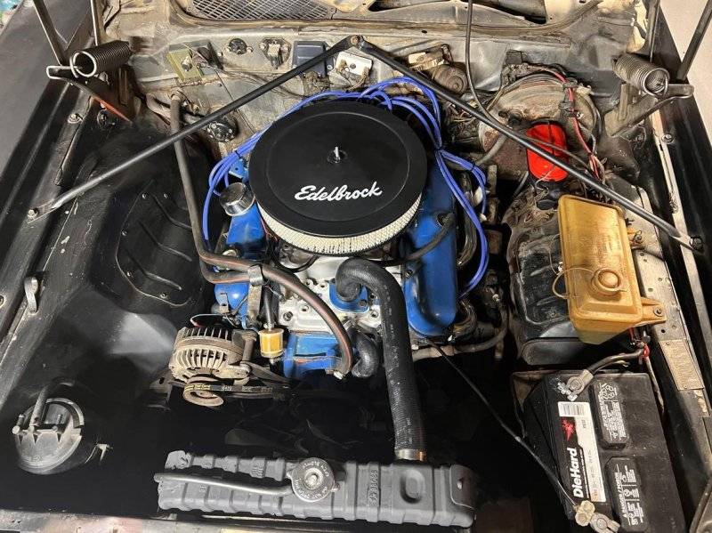

Thanks for all the great suggestions. To answer a couple questions I guess I would like to see if I can get another 30HP or so out of it without any major work. I also know I've got a lower compression engine due to it being a 1973 so I'm just hnt sure what my best options would be. So I'm not looking for a drag strip car, but a little more fun to drive would be great. Right now it's a wonderful daily driver. But its "get up and go" wouldn't be much better than driving a honda or toyota. It's got plenty of power to get moving but nothing too fun if that makes sense. Budget would be somewhere between $1000-$1500.
I guess I'm asking, if you inherited this car today and wanted an increase in power and torque, what would you do?

It has all the what I will call the level 1 and 2 parts on it. (intake, carb, headers, dual exhaust). You may want to pull your distributor out and send it to @HALIFAXHOPS and have him recurve it. It can make quite a difference. What rear gear are you running? A 3:55 will wake it up and still allow you to highway cruise at a reasonable rpm. The next big addition would be cam and heads. The cam really needs to be matched with the heads or you will be doing that modification twice. There are thousands of cams out there and there is no "Perfect cam" The heads are for increased compression and efficiency. Closed, chambers, larger valves, and bigger smooth flowing ports will get you there. The only other way to build compression is with pistons. Unless you want to build the engine from the ground up, leave what you have in there.
I asked Edelbrock what to use, and they suggested a Performer, which is the same name they call a lot of things. I have the same carb but with a manual choke, same manifold.
Electronic ignition. No mods to the stock exhaust until it fails.
If the stock cam has the fibre gears, I suggest removing it as soon as possible. Replace with a new double row chain and new gears. My heads are still stock, bout oil consumption has increased with the umbrella valve guide seals.
We are 6700 pounds loaded, and definitely needed more giddy up. I also put in a shift kit, in the 727.
Going to a 340 or 360 head requires more than just putting the heads on it.
Because of the chamber volume and port size on the 340/360 heads it will drop the compression ratio on your 318 by 1 point!
So if you have a 8.5:1 now, it will have a measly 7.5:1 with the other heads on it.....not good.
But if the budget allows a new set of pistons, then a head swap is a good thing. Zero decking is another option to up the compression.
I agree with the others here, with going with a 340 cam or one that's similar and switching the rear gears to either 3:23's or 3:55's.
I currently have 3.55 gears. when you say 340 cam are you talking about the stock cam out of a 340 LA Mopar and leaving my exsisting heads?
