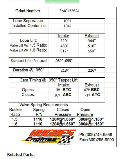

I would love a mopar purple. Cam, but I think I would have to replace springs from the stock springs with the lift. Also will stick pushrods work? I trying to see what someone else has cheaper so I can afford new springs, locks and retainers if need, plus I need a double roller

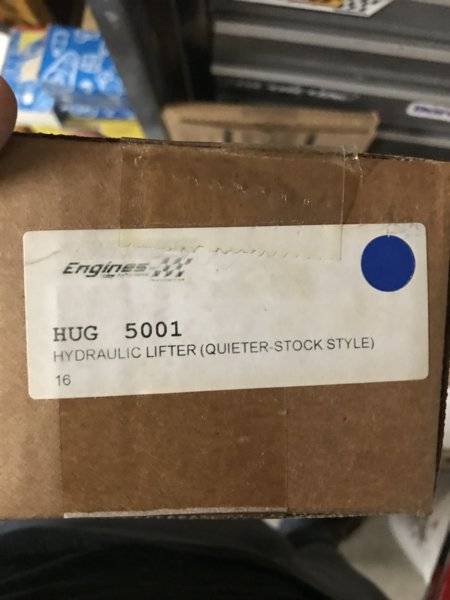

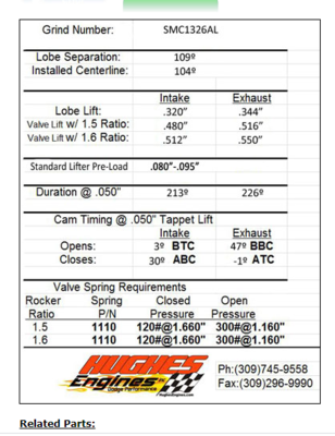

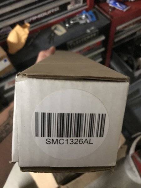

Mine is a Hughes Whiplash SMC1326AL. I have cam and lifters both new in their original boxes. It's a fairly mild cam but has a aggressive idle. These photos are when I got it. It is still in my parts stash but I can dig it out if you need more photos. Send me a PM if you are interested.

Your probably lower than 8:1-1.
IMO, tool a Mike has a good cam for that low compression mill.
