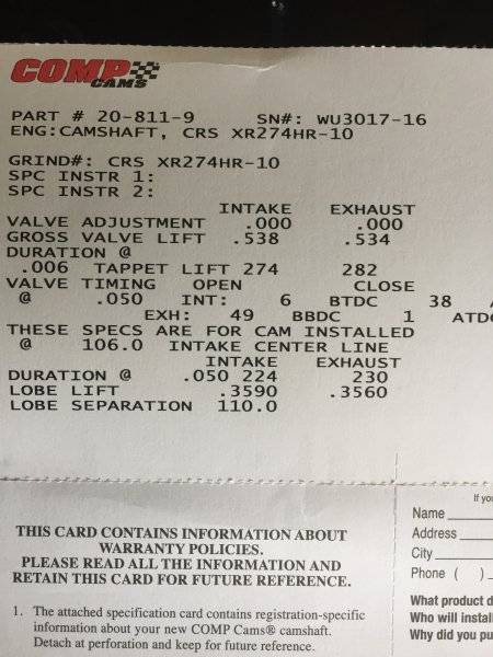

The Hyd version of the below Hyd. roller with less lift.
Cheap and easy.
I’m doing this roller (same/similar as the HFT) in a 360 w/3.55’s on a 26 X 10 tire 2500 stall. (I like your stall better)
Works well for a very streetable high torque combination. Top end HP is good. My intake track is a 750/RPM/TF heads with a TTI exhaust end to end. Trans is a 904. Cars weight is sub 3K - ‘67 Barracuda.
If there is a way to up your compression ratio, I suggest it.
