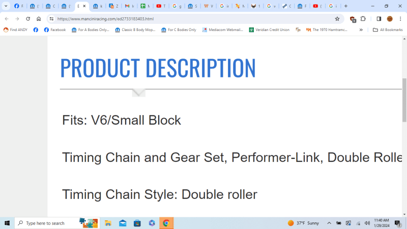

I got a hold on a engine. Builder I used on my old 69 Dart ,he is going to degree the camshaft,he told me to get a 3 key way sprocket,don't want to sound like a dummy on the phone when ordering,so could someone help what's good out there.thanks again.Don.
THese are good ones. Edelbrock Performer-Link True Roller Timing Chain Set See the 3 slots in the crank gear. (small gear) That's what you need. If you want to read up on the subject, Karl wrote this and it contains a lot of good info. How to Rebuild a Small Block Part 10A (Optional): Timing Chain Options
The older Chrysler V6 is a 318 minus 2 cylinders. I had that V6 in my 2003 Dakota. Same timing chain for a sb V8.

I hit that link it says v6
Look closer.
