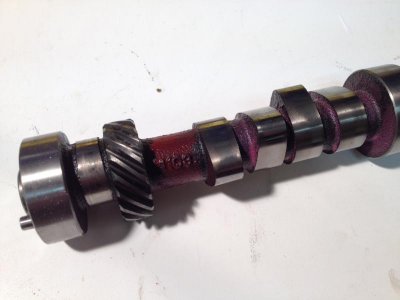

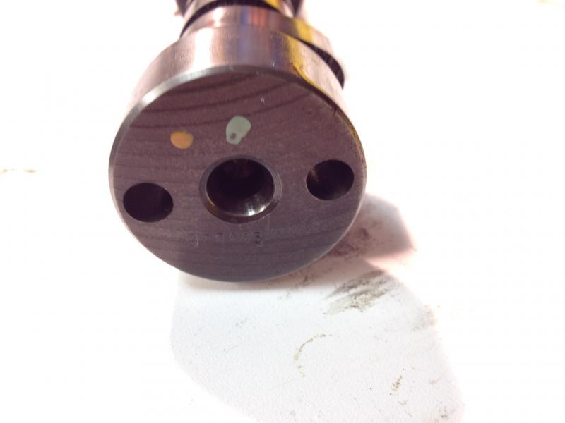

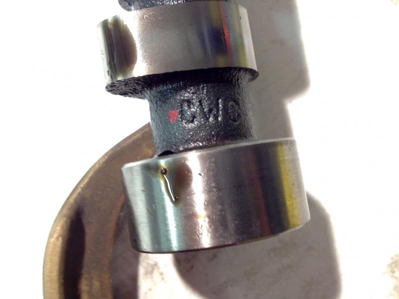

Can anyone help me identify this camshaft?
It's pulled out of a 440 six pack.

We know it's a purple shaft for a big block so measure the lobes to get the lift and multiply by 1.5 (rocker ratio). To measure the lobes get some dial calipers and measure side to side then heel to toe and do the math to get lobe lift. Then X 1.5. I've never made any sense out of those numbers so doing what I described will nail it in 10 mins.
