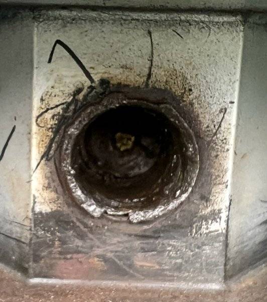

Can’t get new reverse light bulb back in socket on my 1972 Plymouth Satellite
tonyp25
1:40 AM
Jun 25, 2023
161
90
NY, USA
So the old bulbs were rusted and not working. I got them out, cleaned the contacts and when the new bulb touches the contact it now lights up just fine. However even with bulb grease I can’t get the bulb to stay in. They just keep popping out. Almost like they aren’t in all the way but I’ve confirmed they are identical to the ones that came out (1156’s). Is my only option to solder in new connectors?
Has anyone had this happen before?
Are you depressing the bulb enough so the tits slides into the holes ?
I have had problems with Chinese junk bulbs not lining up correctly to the holes. It could be the bulbs, unless those are the same bulbs that you took out, then never mind. If they aren’t, check them against the other bulbs.
OK, before this thread goes off the rails.... :rolleyes: can we get a picture or two please???
I'm thinking he has the wrong Lamp, and maybe has one with offset location studs, instead of parallel studs.
Bulbs grow in the garden. :poke:
Careful now or I'll set Bob onto you lot. :lol:
He already told it got the 1156 BULB (LOL), which is parallel.
My thought is socket is enlarged or worn so is not catching the retaining BULB pins
It could be also the BULB pins are “sank” or pressed into the BULB base. It happened to me couple of times got a BULB with this issue.
What could be made? get a large plyer to try to “close” GENTLY the socket opening from back.. dunno if you know what I mean.
Rusted springs can be a problem also.
Cleaning on the visible part of the lampholder is one thing, but are the springs inside clean and able to run free?
Well all, now I can’t even get either of the reverse lights to light up when pressing the lamp bulb against the contact. Lamp bulbs won’t stay in either. I think the sockets are just too far gone and rusted. How often am I backing up any way? I was thinking of trying a few different brands of 1156s but I no longer think that’s the problem.
Put the sockets in something that penetrates rust. I feel compassion for you and those sockets. Makes me grateful that we live where we do. We complain about cold and snow.
The only car I have seen about half that bad is a parts car from I think Michigan.
A picture is worth a thousand words. I think you identified your problem. Time for new sockets or housings.
I had problems with bad tail light springs/sockets not making contact. After cleaning, spring was shot, bulb not making contact.
What I did was get a soldering gun and add more solder on bulb contact to make it taller. Trial fit then filed them down until they twisted in. Still need to replace the whole socket and wire but this works.
