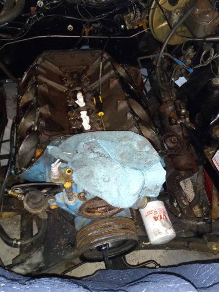

Another update to operation SE get er goin! So I am still trying to get the motor to turn over or I guess break loose. I need this to happen so I can get to the flywheel bolts. Unless I can move the motor ahead far enough to bring the flywheel along with the torque converter out. Or I guess the motor and transmission. I did get the oil pan dropped and thankfully the crank and rods etc look fantastic. Even the cylinders look great. The first pic enclosed shows my setup for filling the cylinders full of Vinegar. I let the stuff boil for about 4 days. After that, I removed the plate and bingo, no more rust. Pretty neat deal. I had forgotten how well Vinegar works as a rust remover. Second picture is where I'm at right now. Need ideas on what to do to break this thing loose!
Also, I've decided I'm going to bring this thing back to its original setup, ie the 4 barrel manifold and carburetor. Makes more sense than trying to figure out the 6 pack setup that was put on it. I'll shelf that for now. I'll need to research what carb and manifold will be most authentic to for the 72 440.

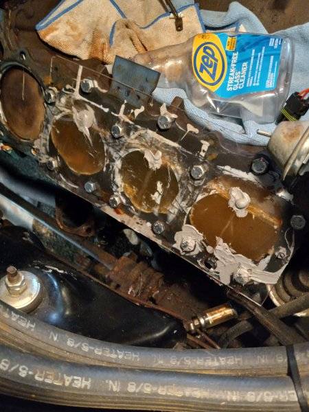

Time for another quick update. I created a template of sorts so I could soak the cylinders in vinegar, **** works great! 1st pic is before, the 2nd during, and the 3rd pic after. I also had a chance to drop the oil pan and the bottom end looks very clean. This is great news. Right now, even after the soak, the motor is still stuck. I'm not real sure how hard to try as I'm afraid I might just twist the crank bolt right off.
Also I've made the decision to put the top of the engine back to OEM. I've sourced a manifold and block, but I am really confused on the correct air Cleaner? Even when looking at a web site that had all of the air cleaners from back in the late 50's up and through the 70's I'm still confused. Should it be a dual snorkel cleaner? Anyway, still need the engine loose to get at all the flywheel bolts to pull the thing.
Orange, dual snorkle air cleaner with rectangular snorkles. Time will loosen it up, keep trying it.
Just pull the engine with the torque converter attached. Once it’s out you can remove the converter and flex plate. Once it’s on a stand you can unbolt and beat whatever it takes to get the pistons out.
Travis..
Instead of vinegar, try auto trans fluid, or even WD-40.

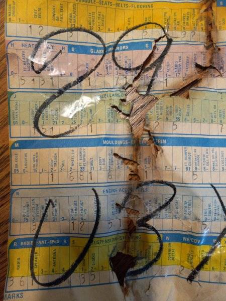

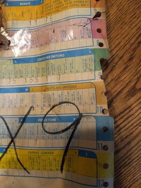

I was not really getting anywhere on the engine tonight, so I decided I should have a look around for the build sheet. I had looked under the back seat and behind the glove box a while back. Just for the heck of it I grabbed a light and stuck it under the driver's side seat. Bingo! Now I just need to figure out what it all means...
Congratulations on finding the build sheet! When I have to unbolt the exhaust manifolds,that last bolt on the drivers side manifold back near the firewall can be tough to get broken loose. I usually put a deep 9/16 socket on the bolt first,then slide the ratchet carefully in between the brake booster and steering column shaft and get it onto the socket. You have to position the square part of the ratchet so it will line up with the socket and push it onto the socket, then you will be able to break the nut loose.
Here is the breakdown of the Broadcast sheet:

Very cool that you have a broadcast sheet for this car! There is a lot more info here than what is on the fender tag. The first couple of rows are some of the main appearance info for the car along with the VIN - paint colors, etc. Lines 3-6 are specific parts that are supposed to be installed on the car - the digits are the last 2 or 3 numbers in the part number of that item. Example - Fan 16 - the part number for the fan mounted to the engine ends in 16. Steering wheel 12X9 - part number ends in 12, and X9 means that the color of the steering wheel is Black. Then lines 7 onward are all the option codes for the options installed on the car. That should get you through most of the sheet - there are a few boxes on these sheets that I am still sorting out. If you have any questions - just let me know. Have fun!
Yeah, I'm pretty lost on a lot of it. Thankfully some of it is self explained, but one thing that is confusing is the section that has STRIPE as the header, 1st = V1X and 2nd = V7W? The car has no stripes?
I see V5X in the Stripe box - which is actually the chrome and black protective side moulding, and not an actual stripe. The V7W is for a painted white pin stripe that runs along the body lines on the side of the car somewhere - I am looking for a pic on the web, but not finding anything yet.
Yes, I see that now. The car currently has neither the side molding or Pin Stripe.

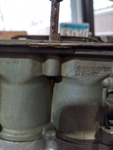

I thought we might go on a little tangent today and talk 6 pack. As you know if you have been following along, the 72 came with a 6 pack setup on it. We also know there were only about 3 72's that somehow snuck out of the factree with 6 packs and they have a V in the VIN. Anyway, I've sourced an original manifold and Carb for the car, but I thought I should at least try and understand what I have as far as the 6 Pack setup. I've read on the forum information on date codes etc. So, lets first talk about the manifold. The #'s I see are first a sideways 6, then 2946276. If I understand what I've read this tells me it is a later version that has less of an issue with being porous?
Now lets talk carbs
Back Carb first: I see #'s H14 on one side, then 2489 and under that it is List-4672
Front Carb next: I see #'s H-14 on one side, then 3389 (I think) and under that it is List - 4672
From the little bit I've read the first three #'s are days and the last # is year? So they would be 72 carbs?
Middle Carb: List-4670 and date code of 0480

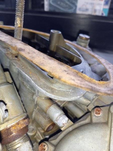

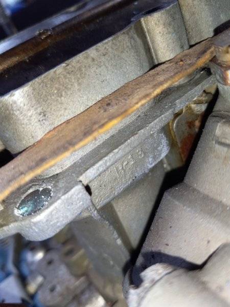

Now the interesting one, the middle Carb
So I do see the H-13 at the same location as the front and back carbs, but I see nothing on the other side of the Carb. I see a few #'s on the top of the carb:
1605, then I can only make out L46-- and then 6020, strange? Is there somewhere else I should be looking for the middle carb date code?
Adding pics
Now lets talk carbs
Well then, found a chart that shows 4672 = rear carb, so I guess the setup I have has two rear carbs on it..........no front. I'm still trying to figure out the middle Carb #'s
