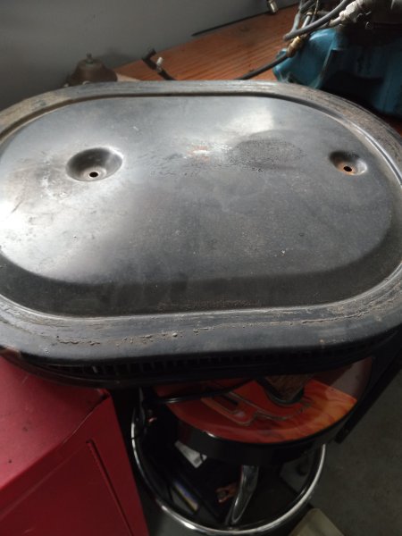

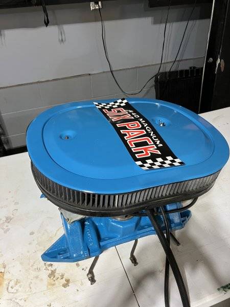

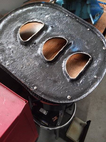

I love this car and it certainly is yours, however that Six Pack has been on the car for more than half it's life. I'd be tempted to leave it on. Nice to have the 4 bbl setup to remain with it though.
My biggest issue with the Six Pack is I have no idea how to make it run! LOL! I guess I better hang on to it and maybe run the 4 barrel for a bit, then try to get the Six Pack running? Man, I don't know!
Ha, ha: Honestly they're both good choices. The Six Pack is no more complicated than the 4 bbl, actually a bit less complicated. Three very simple 2 barrels to rebuild and set a couple of adjustments.
On paper maybe. Mixture adjusting is certainly not a 2 second thing like a 4 bbl.
Well, with both the front rear carbs being rears, wouldn't I need to change something out on the front one to get it to work right?
Interesting. Minor jetting changes ( I would assume!).. but in the end they are both out board carbs.

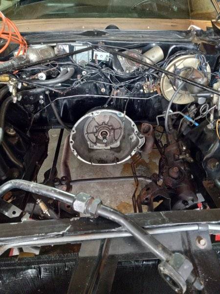

A little update on the effort to get the ol Charger going again. I finally had an afternoon yesterday to get the motor out of the car and over to the machine shop. I did also get to confirm that the mota is original to the car. This is good!! LOL!
I was able to spend about 5 hrs this last Saturday cleaning the engine bay. Ended up pretty good. Still need to finish the K member paint. Question to yous.....any idea what can be done to get rid of the rust on the ac lines? Please see the enclosedpics. The line(s) are in good shape, but have some rust. Would be nice to not have to replace them

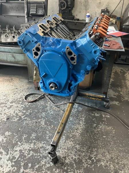

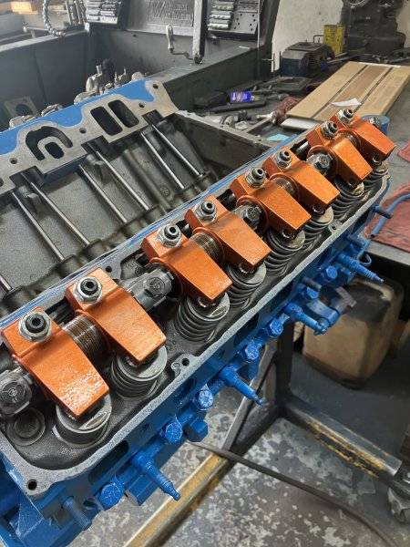

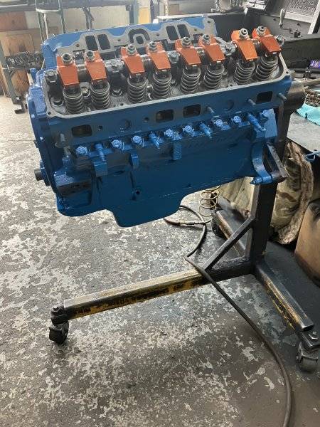

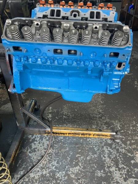

At long last I have an update worth mentioning! The Mota is finally complete. Time to pick it up and find some time to drop it in. It ends up as mentioned before the thing was already 30 over. It is now 60 over with one cylinder being sleeved. Hell of a deal. So, all new pistons, 9 valves, cam, bearings etc. The crank, block and rods are still original. Enclosed are a few pics including the engine invoice.
