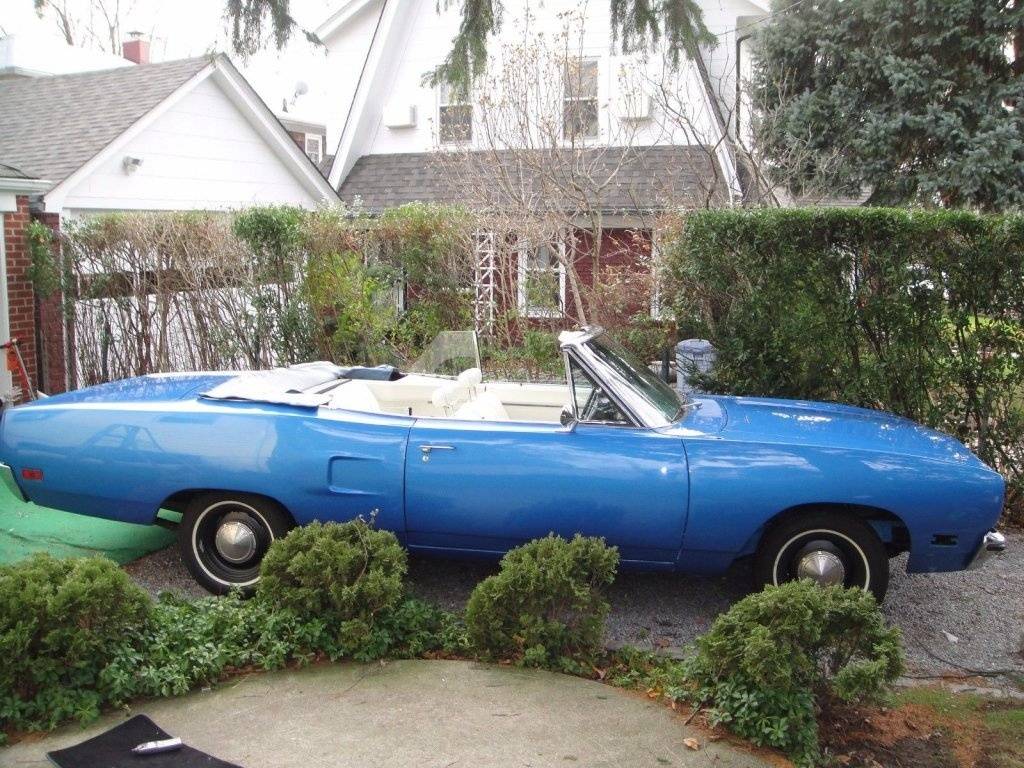

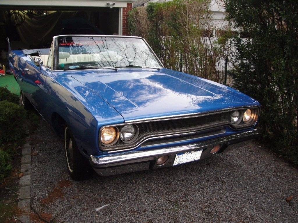

Well, the question of this post is moot for me now. Lady luck smiled upon me and this basically fell in my lap. And, it was right in my backyard. Picking it up tomorrow. Will post more pics then. Also, since I only have one garage for my toy, I'll be putting my 70RR up for sale. Forum members will get first crack.

As I just posted today, doesn't matter to me anymore. I found a 70 convertible.
Nice to see you took my advice. BTW, your purple Road Runner is a nice looking car.
My post was more of an intellectual exercise to determine what would be involved in doing that kind of conversion. I never really seriously considered cutting up my RR. It's just too nice of a car. You had some valid points but the clincher was DSD1967's response with all the detail.
I'm sorry to see the RR go, but really want the ragtop. I will get much more enjoyment out of it ( of course dropping in a big block might be nice !!!!)
