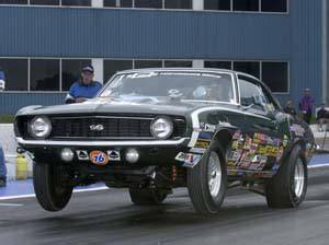

Let’s not forget Kevin Helms 3 time stock eliminator national champ and back to back US Nationals winner in a 396 4 speed Camaro.
https://www.dragracecentral.com/DRCStory.asp?ID=30460
Don Keen stock eliminator national champ in a 428 4 speed mustang

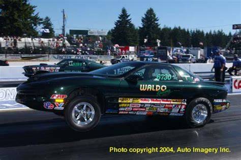

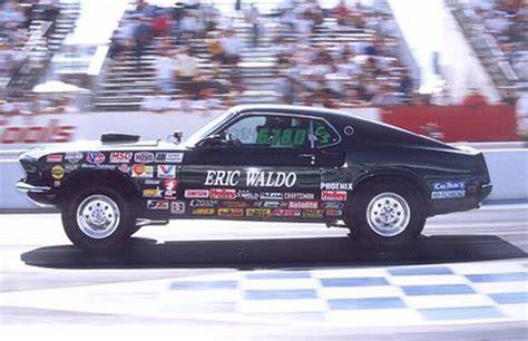

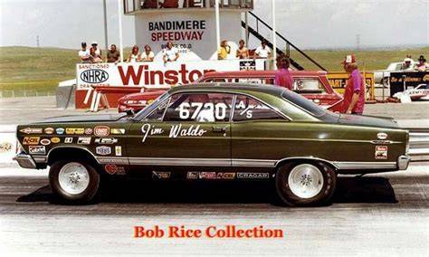

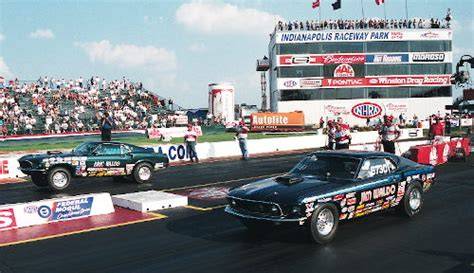

Jim Waldo 2 time Stock Eliminator national champ in 4 speed 67 Fairlane and 69 Mustang. Later built a 4 speed firebird that won the US nationals A/S shootout multiple times with that car. Both of his sons have Each won the US Nationals and multiple other nationals in BB 4speed Nova and Mustang.
So saying a manual trans can’t be competitive is false.
