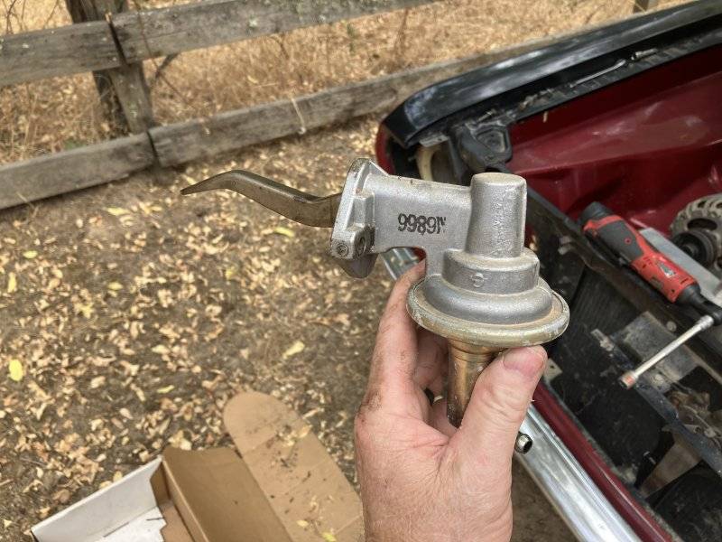

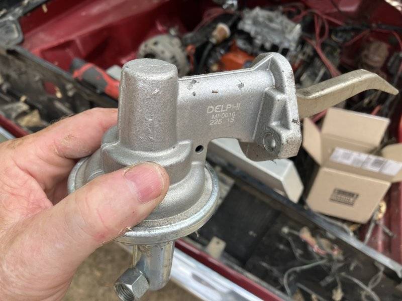

Can a stock fuel pump put out TOO much pressure?

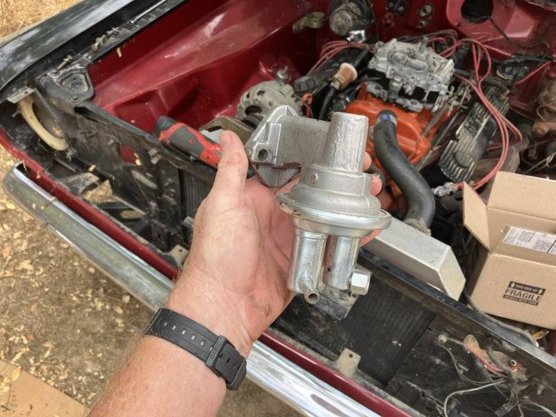

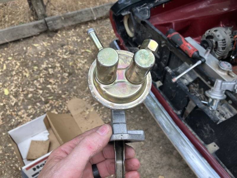

It looks like this:
I changed to another one that looked similar.
Delphi?

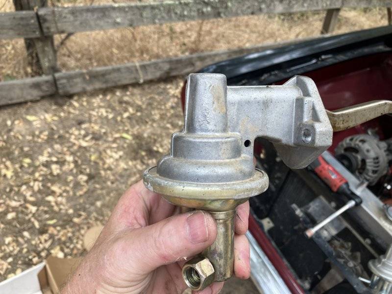

It started and ran fine…. Then started puking fuel through the inside of the ThermoQuad.
The threaded fitting on the pump that feeds the carburetor has a leak. As I tightened the line, the pump body twisted a bit.
Two pumps, same symptoms.
So...the answer to the OP's question is of course "yes" - but you won't know for fact until you put a gauge
on it.
Get a gauge on it for test so you'll know exactly what you have.
Really need a gauge on it to accurately answer your question. Otherwise you are just guessing.
Pressure gauge is probably next or your just guessing. It sure sounds like to much pressure.
^^^ First thing we did when someone came into the garage with a similar symptom. Gauge it. Confirm it, or rule it out.
This guy get's it. Diagnose and repair.
It looks like this:
Delphi?
I'd say that's a lower pressure 2 valve pump, but a pressure gauge will tell the story.
Test the pressure at the carb with a good gauge and install a regulator to reduce it to 4-5# if necessary. I have experienced a new, out of the box pump, from
Car Quest put out 10#. The application was for a 383-2 barrel so no "high performance" application. We replaced it because the old pump was putting out 7# and bleeding over both a Edelbrock and Holley carb.

It looks like this:
Delphi?

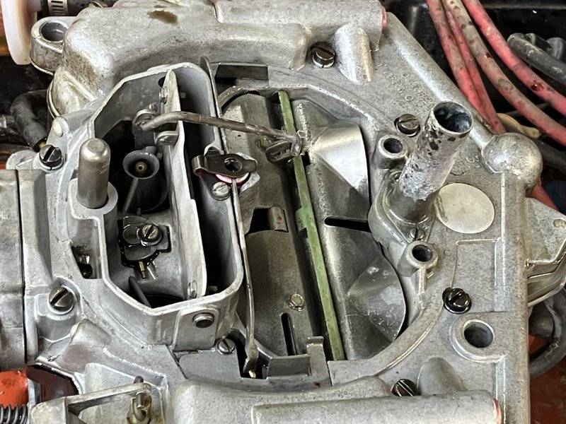

When running, it flooded the Holley.

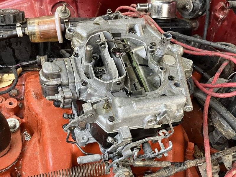

I pulled the carb, changed the needle and seats, power valve and a few gaskets. Back on, it still floods over. I put a ThermoQuad on. It floods over too. Fuel pump? Okay… I swap in another and the flooding continues. The second pump has a twisted fitting that drips so I swap in another pump.
The ThermoQuad still floods.

I used the carburetor from this car:

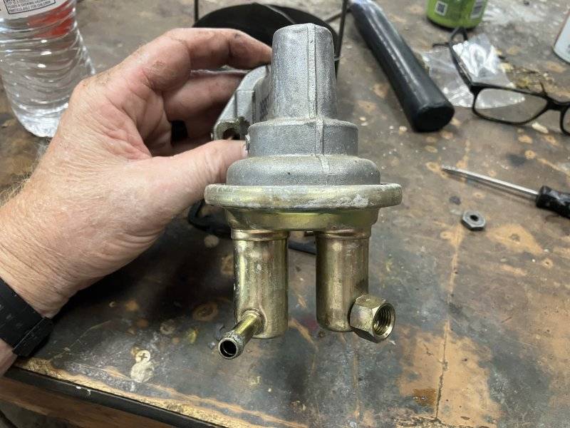

Along with the fuel pump that I had in the car before:
You know, the one I first thought might put out too much pressure?
Boom. It idles great, runs great and doesn’t flood over.
The problem was not high pressure but bad floats or something in both carburetors that allowed the flooding.

When I pulled off the THIRD fuel pump, I blew air into the suction line to the tank. I could hear bubbling inside it. I then I ran the suction side line to a water bottle, then pressurized the tank with the air hose. The line flowed fine both ways. The water bottle filled with fresh gasoline.
With the pump in place, it neither pumped nor allowed flow of fuel via pressurized air.
The Bowls of the Holley did have a light amber colored film to them. I do use Sta-Bil which is red in the bottle but fades when mixed with the gas. The gas will look a very pale yellow when fresh but will get orange over time as the volatile components evaporate.
