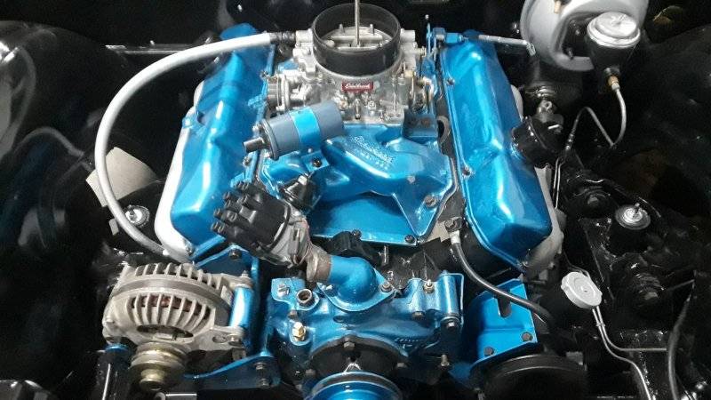

Man you bring back memories. I use to take the a/c off everything. Extra weight. In the way. Less is more. Now I’m old and if it didn’t have a/c it gets converted. Anything you take off just save. One day you might want it back on there.
First of all it’s awesome to see a 14 year old with a b body. Heck I thought I was one of the younger guys at 34! I like the clean engine bay too and deleted all creature comforts in my 64. No heat, no blower, no AC, no power steering or power brakes. You will need different pulleys and such but keep the original stuff bagged and tagged. One day you may want it as mentioned above.
I always remove the ac from my old cars. Small blocks are easy just measure the length you need and bypass the ac. You will only be able to run one belt as the other would hit the water pump. Big blocks are more of a pain. I didnt feel like trying to find the non ac brackets for the alternator so i made my own setup out of an old rusty piece of angle iron i found in the shop. I used an alternator belt from a N/A 88' volvo 740 I already had, it fit perfectly.
