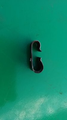

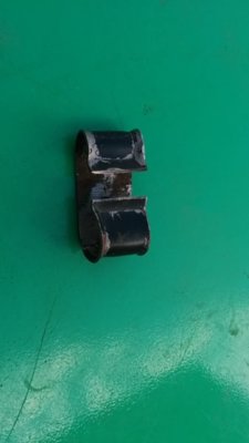

If the floor pan has been replaced, you will also need this piece to hold the cable to the floor pan as well as the cable bracket that Wayne pictured. As a suggestion, once you determine the approximate location of the pedal, install the gas pedal arm that attaches to the firewall. That will confirm that the gas pedal is close to the approximate location as well.

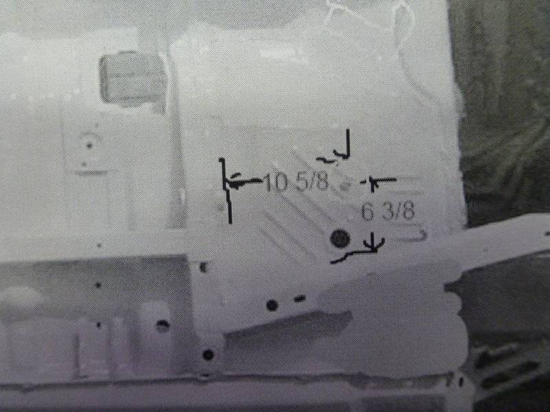

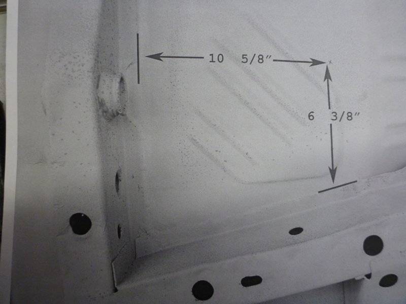

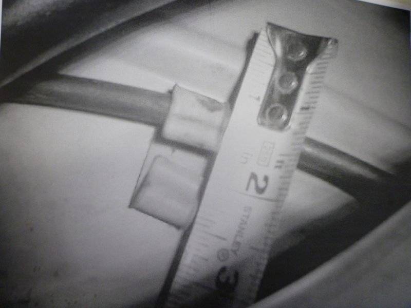

Gave up looking digitally, dug though my paperwork box in the shop and took pictures of printed out pictures.
Speedo clip location (measurements are from edge of flange, not Xmember or frame rail) and a shot of the orientation in comparison to the "rib". No idea what the tape is showing. My clip came in a zip lock bag taped to the floor pan. Life would be easy if AMD just welded it on!
