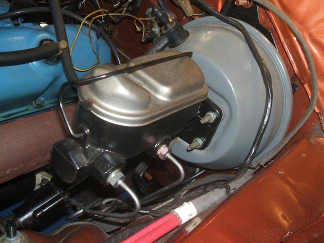

Was wondering if anybody can tell me exactly what power brake master cylinder/power booster I have along with the distribution block in my 1970 Roadrunner (photos below)? Is the dist block also a non-adjustable prop valve? Why I am asking is I have 4 wheel drum brakes on the car and want to convert over to front discs and I have conflicting answers to my question do I need to replace the master cylinder/booster along with the dist block and add a adjustable prop valve or will what I have in place work with front disc brakes?
The car was "restored" around 10 years ago in canada and working on it in the past year I have found some things that were not done right using different parts, etc......
Thanks
PS Update: Checked the numbers on the bottom of the master cylinder and they are
3966593.
Checked through the brake section in the shop manual and it does not even show this master cylinder....thinking maybe it from a different year or maybe even a different body style?

From what you have pictured,the booster is Midland Ross which is correct for power drum brakes in 70,the cylinder appears correct but may be a later replacement,valve also appears to be correct.Difference in cylinders is usually bore size and residual valves in the inlet fittings for the lines.
If you look at the service manual you can see the additional parts needed for Disc/Drum set up. Your Booster and MC probably will work. The small reservoir should have a residual valve behind the seat, and the larger (front brakes) should not. You need to add a Front Disc metering valve (hold off) and a rear proportioner (if it is not installed). Or you can go to an after marker combined valve. Right stuff has the brake lines, and valving. Others sell the 3 piece valving as a set on Ebay. do asearch and there are some post that explain what all the pieces do for a disc/drum power brake set up. G
