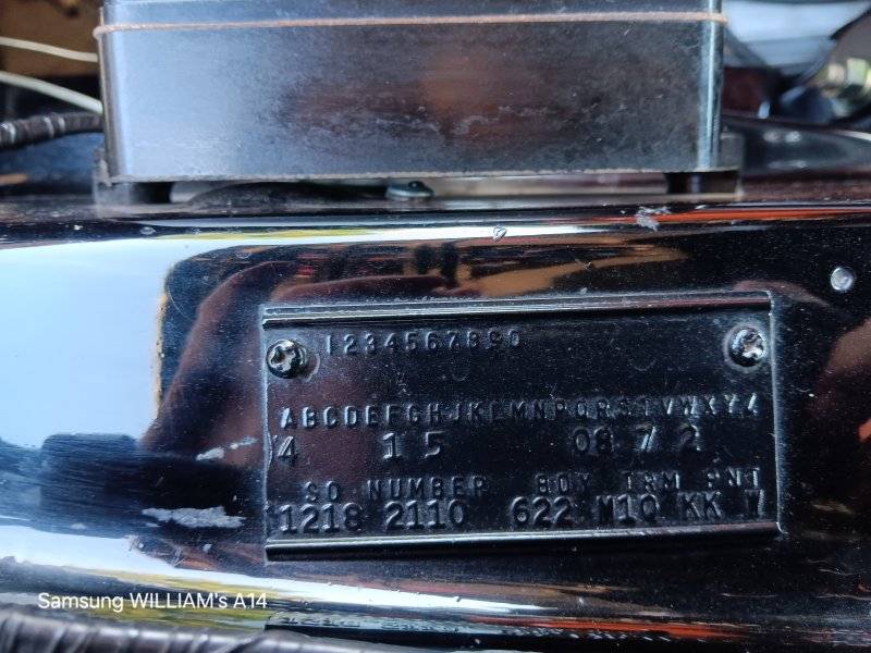

Can someone please help with decoding this fender tag from a 1964 dodge 440? Thanks

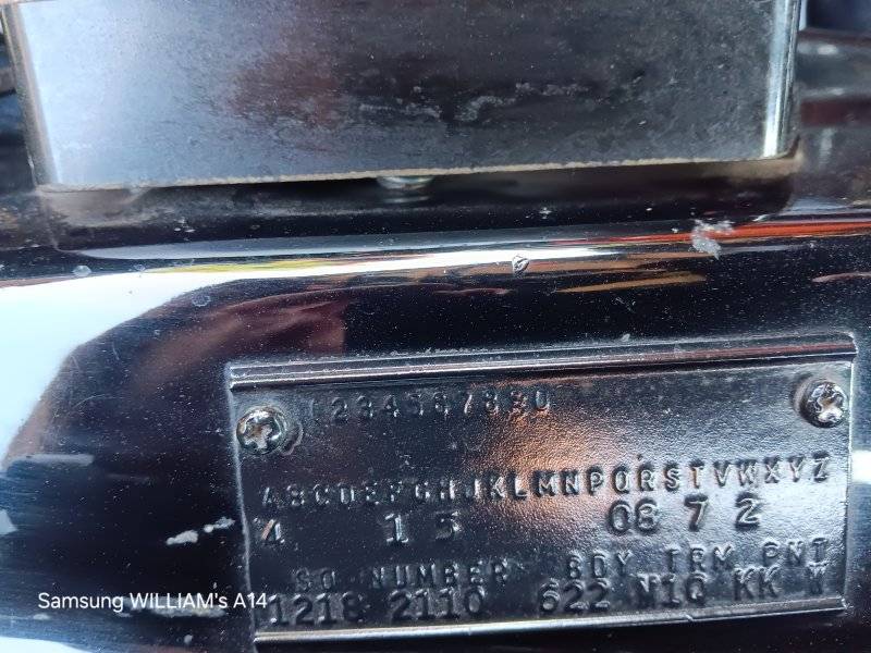

If the fourth digit in the VIN is a 2, then it is a max wedge, three speed floor shift car. Let me know, and I will decode the rest.
1218 2110 is the shipping order number, the1218 part is the scheduled production date, Dec 18th 1963. 622 is a V/8 Dodge 440 two door hardtop. M1Q is turquoise bench sear interior. KK W is turquoise roof and body colour with a white sidesweep. 4 is T-85 three speed floor shift. 1 is AM radio. 5 is heater with defroster. 08 is 426 max wedge, 415 hp. 7 is 90 amp battery used on max wedge and hemi cars. 2 is sold car, which means it was ordered by a customer.
Wow, thanks alot for the helpful information.
