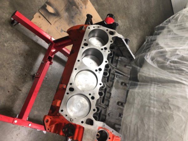

-383 .020 over, so 4.27 bore
-Pistons sit .037 down in the hole

-Piston are neither domed nor dished. Flat top I suppose. Just an elcheapador cast piston like silvolite maybe or equivalent.

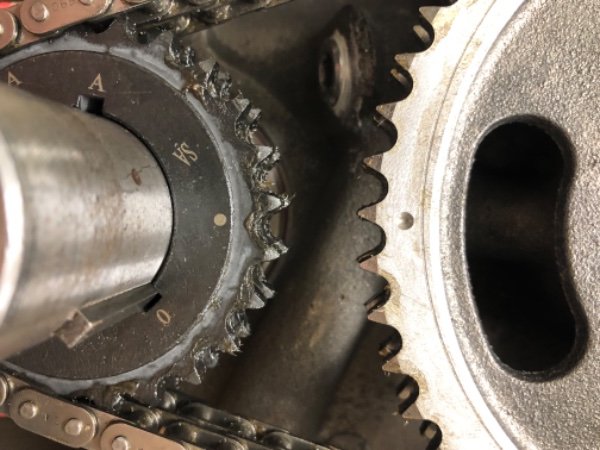

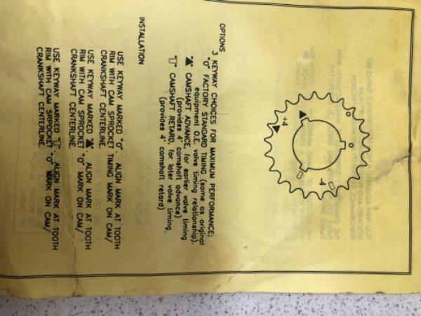

I have the SA Gear double roller timing set pictured, not sure if advancing or retarding with cam is recommended by you guru’s? Or just straight up. I think the choices are 4 degrees either way. Or do I just have to degree it to see where it’s at?

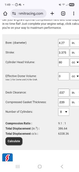

I use Summit's calculator. You need to cc your heads to get chamber volume. Also need to know your actual head gasket thickness or calculate it both ways to see the variation. I assumed 80cc chamber volume and 0.039 compressed gasket thickness in the calculator below. Says 9.1:1 based on those dimensions.
Without knowing the chamber volume, anything you come up with is just a guess.
But assuming the heads are 78cc, you’d be at around 9.0cr.
Heads @84cc and it’s more like 8.6cr.
