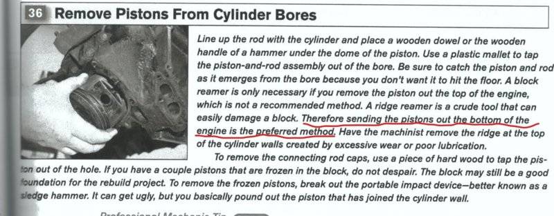

Why does the photo show the piston being removed head side ? You would think a correct photo would be helpful during the writing of the article.. And I'm not even from the "Show Me'' State.
Yeah, I noticed that as well, makes me wonder if he actually did what he states as the better way. The book does get good reviews though.Why does the photo show the piston being removed head side ? You would think a correct photo would be helpful during the writing of the article.. And I'm not even from the "Show Me'' State.
When that was written there was no "tech check" for the article................So I found where I read it. It's HOW TO REBUILD THE BIG BLOCK MOPAR by Arvid Svendsen.View attachment 864318
......makes me wonder if he actually did what he states as the better way. The book does get good reviews though.

Yep, that's the book
